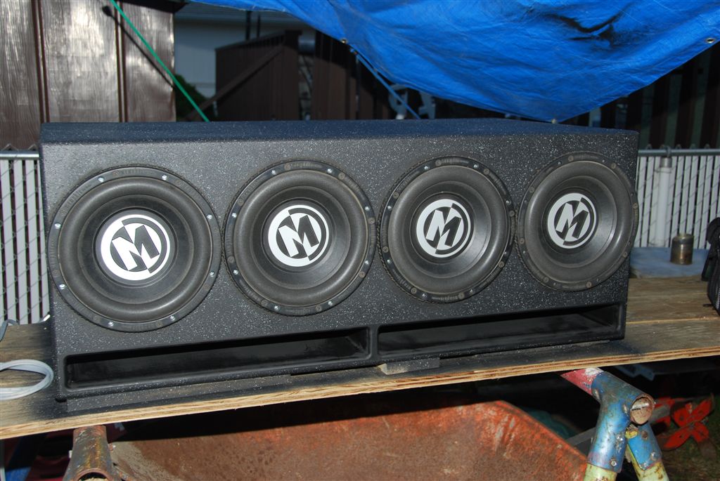

5ft^3 net volume tuned to 36hz. sounds amazing. I love four 10's //content.invisioncic.com/y282845/emoticons/wink.gif.608e3ea05f1a9f98611af0861652f8fb.gif
BTW that is a 2 chamber design and the only reason I did it that way was to elimate the need for bracing. I had these in a comman chamber before but the port was designed/built poorly and they sounded like crap above 45 hz. Now they sound awesome. I listen to everything but country and I havent listened to anything yet that doesnt sound good with this new box.
