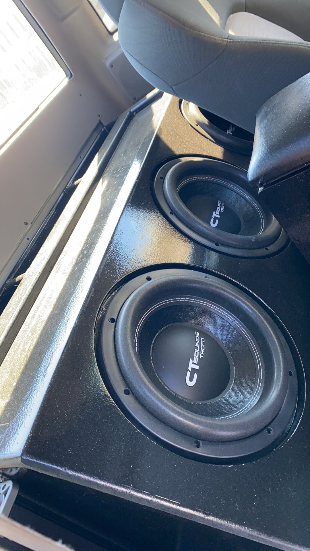

Hey, thanks for getting back to me so quickly! To be completely honest with you, I went with a 15 because I've never had one before lol when I got this truck I put a kicker solo baric l7 12 in it with a hifonics Brutus. It got stolen, so I replaced with 2 Rockford p3d2 12's in a ported box. Someone offered to buy then so I sold them. Then I went with 3 alpine 10's. Had them for a month or so until I got the tropos. I thought going to one 15 would still sound good, and give me a little room in my truck back. I got a 6 year old with me the majority of the time, so space is limited. And I didn't feel like I could get those deep lows out of the 10's.

I believe they're the dvc4's and I have them wired into a 2 ohm load. And I'm pretty sure the enclosure is my main problem. I went off the factory dimensions for one multiplied by 3. And wasn't aware how critical the port dimensions were. I'm an incredible woodworker, Machinist and fabricator. But when it comes to the technological Parr and electronics, I'm not so great. So I have a hard time with the tuning aspect. I am running a high output alternator, optima yellow top agm battery, big 3 with 4 gauge ofc, 0 gauge ofc from battery to distribution box, 4 gauge ofc to Fosgate t1500-1bd, and 4 gauge ofc to Kenwood 400 watt 4 channel, older Kenwood ddx814 head unit, dynamat throughout, and I'm probably forgetting something

A couple of things. First., did you say that you have them wired to 2 ohms? If that is the case, and you are running them in parallel, that is a 0.66 ohm load to the amp, not a good idea. Now if they're dual 4's wired to 8 and all in parallel, that would be 2.66 and you're fine. That aside, what is the volume of the enclosure, the port dimensions, the opening, and the length? The box is everything and if your port is tuned for 1ft and the box is 3, you could be way off and that would be a substantial loss of low end...

My bad! I was wrong about the subs. I've got dual 2 ohm subs not dual 4's. And I'm gonna measure the box as soon as I get home.

Wired to option #1 would be ideal for those subs. I have quite a few 10s. in the proper enclosure, tens can get down pretty good with the right amount of power and the right enclosure for the environment too. Those 3 tens should walk all over that single 15 in the properly tuned enclosure
