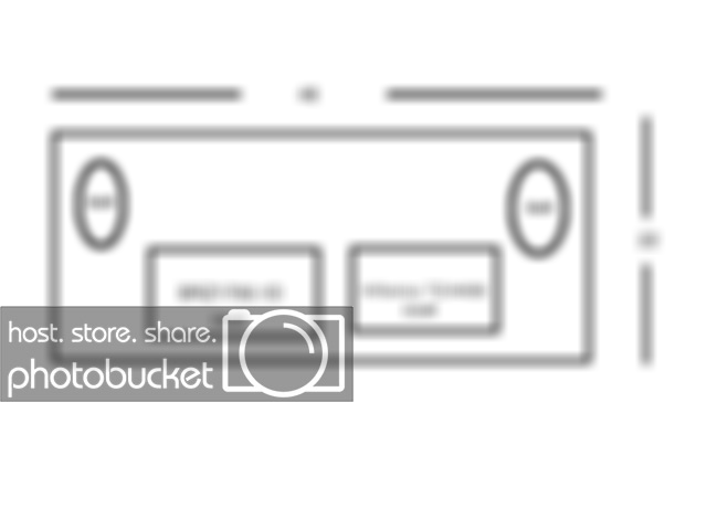

I am going to be building an amp rack, that will place the amps right behind the second row, and angled towards the back of the truck. I was thinking about cutting in some 6x9 holes into it ( which would probably place the speakers right behind the rear seats ) and install the polk there and leave the rear door speakers out of the equation.
Would this be a good option or should get another set of speakers for the doors?
Here is an idea of how I would mount them.
that would be the view if you had the rear captian chairs folded down and you were sitting on the center console
A good set of coax 6x9s will sound good and loud firing from behind, especially built on axis like you have. Im running some in the rear deck right now. When I used to run them 80hz-3.5khz, they sounded great like that.
I think you ll like it.
How itll sound overall depends on the performance of those speakers but if they are good they should sound great.
