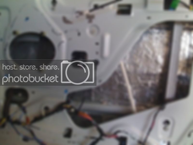

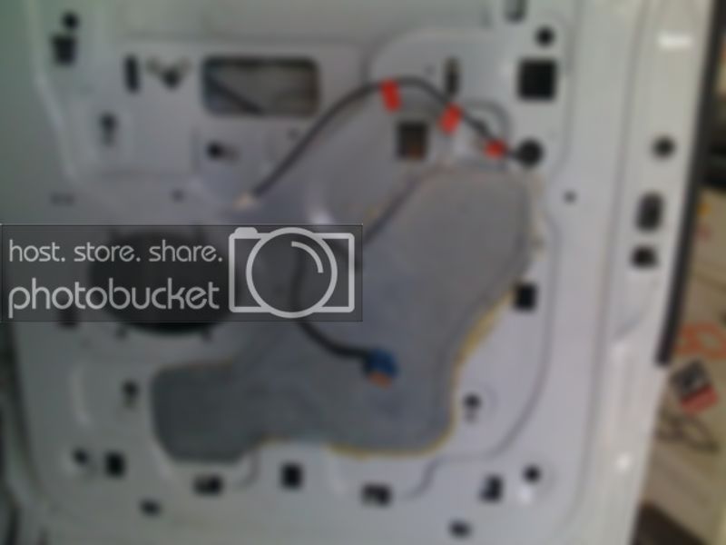

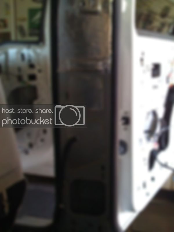

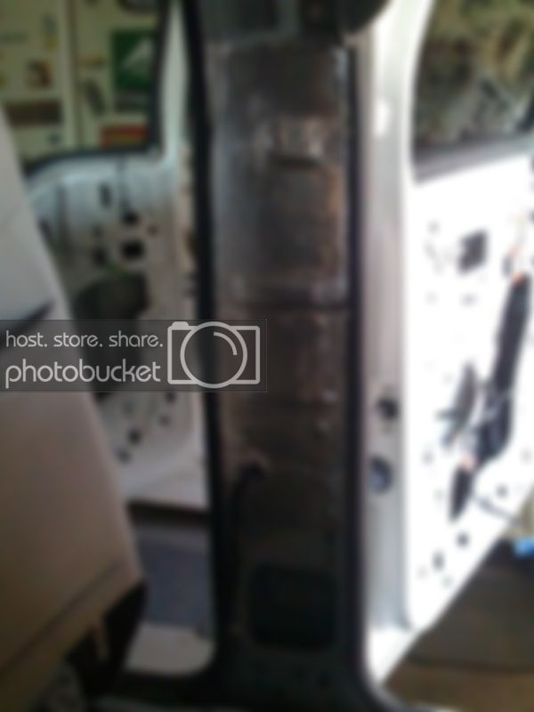

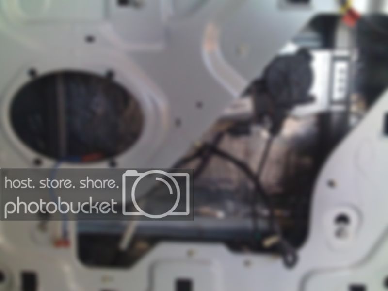

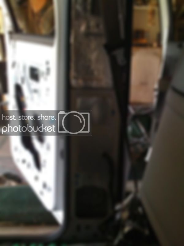

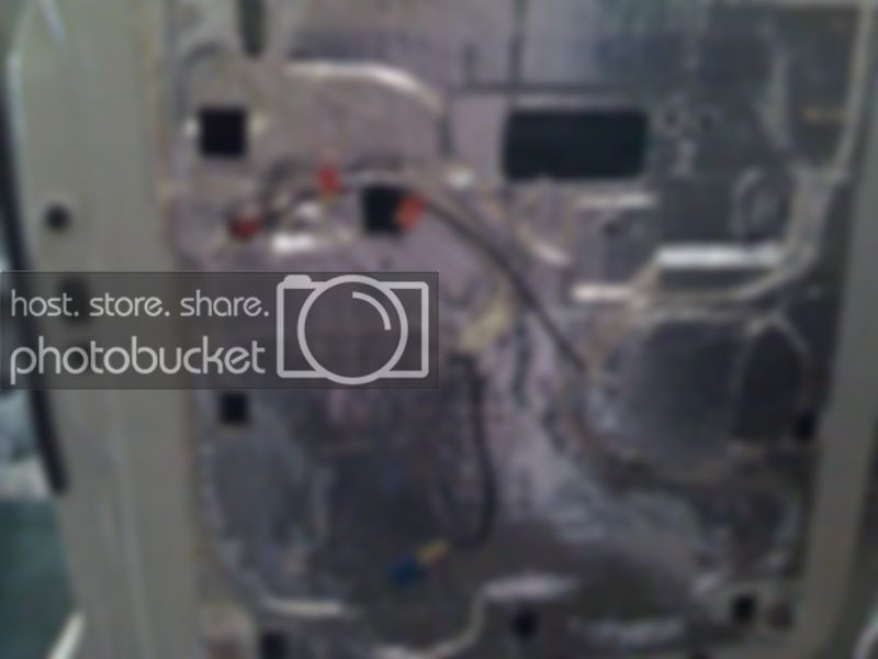

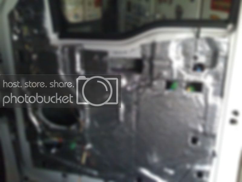

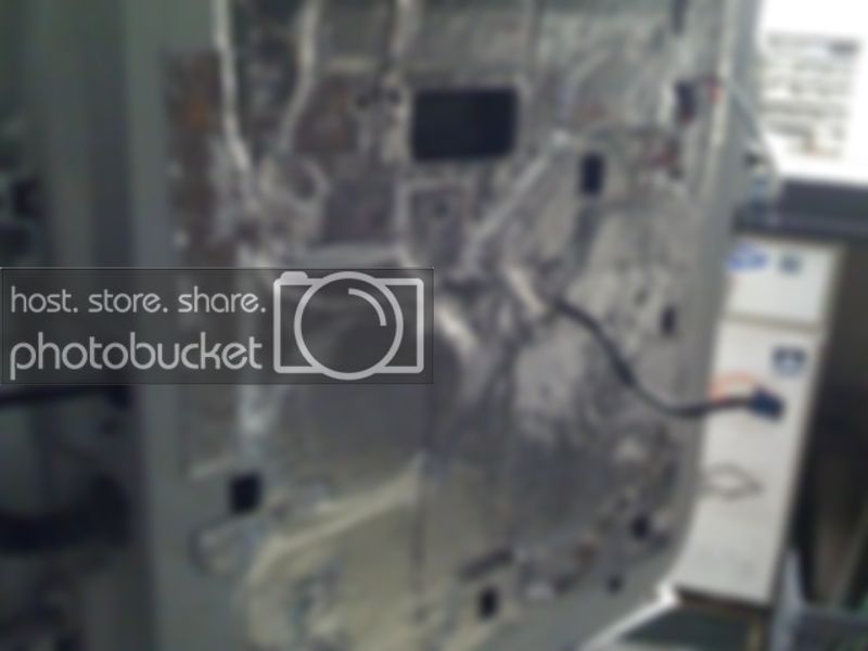

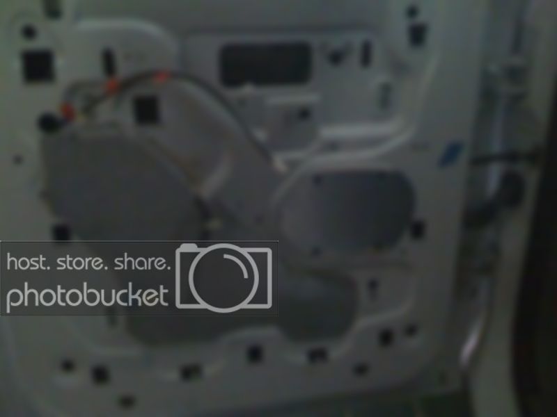

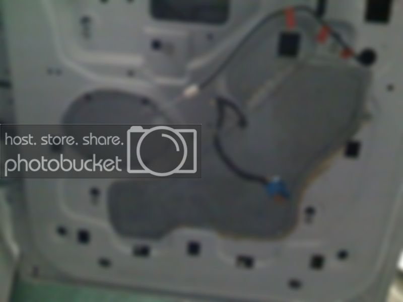

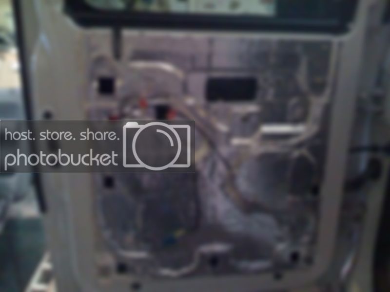

Ford f150 05- bl18, sundown, hertz, big build
hahaa love the box
dang that sure is a lot of mat, looks good though. Hoping to do the same thing in spring.
How many square feet did you end up using and how many layers?

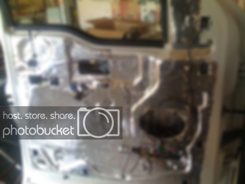

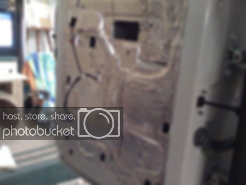

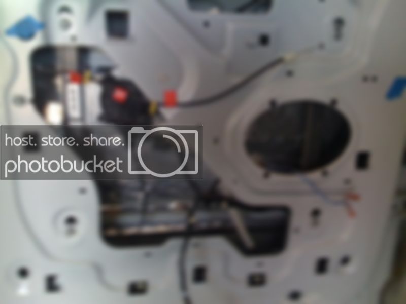

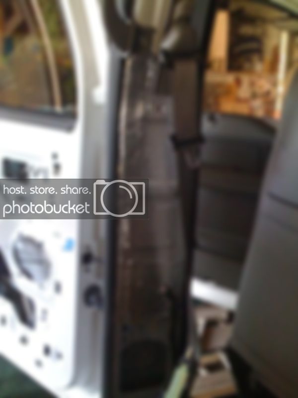

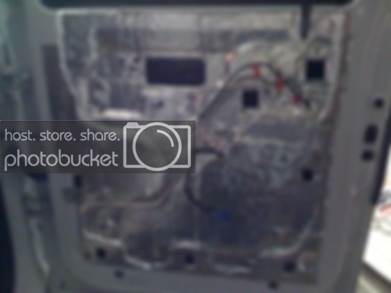

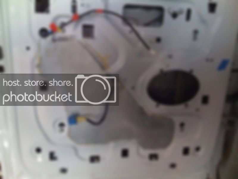

i used about 120 sq ft. of damp pro. i double layered areas on the doors and thats about it.
cool thanks, gives me a ballpark idea of what I should expect when I do my truck.
mine took me a total of about 35 hours to do. that may be because its my first time ever doing it so i didnt really know the tricks but yeah suspect it to take much longer than what you expected. also dont rush and just take your time the first time and do it right so you dont have to do it again.
