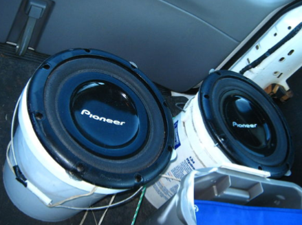

If I HAD to choose between the two I'd personally go with the Pioneer 12.
