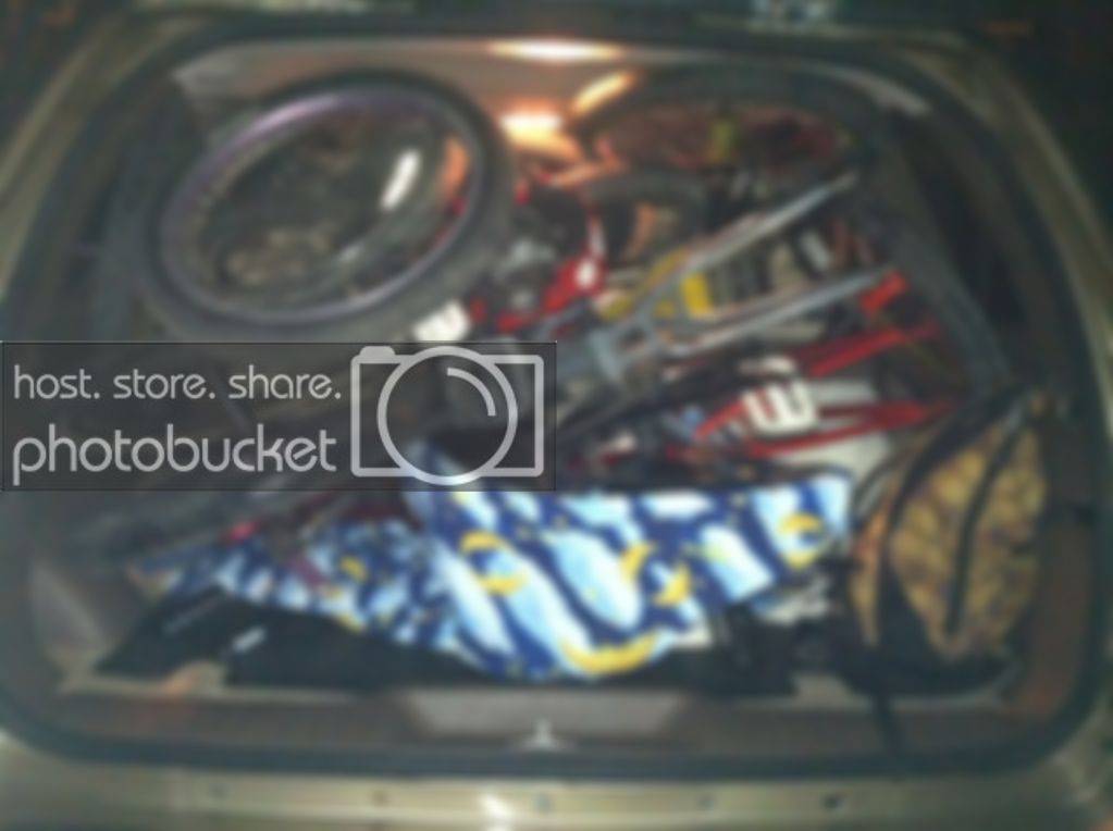

Also, as far as size restraints go, I still want to be able to fit bikes in the back, as I'm a huge BMX rider and my car is used regularly as a trip car for parks and street spots up to 6 hours away. I fit these, 6 bikes, into my car with a 12" Alpine Type-S in a 1.2 cubic foot sealed box without disrupting the subwoofer.
EDIT: I know the box was too big for that subwoofer. It was all I had though, unfortunately.
