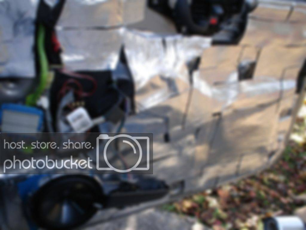

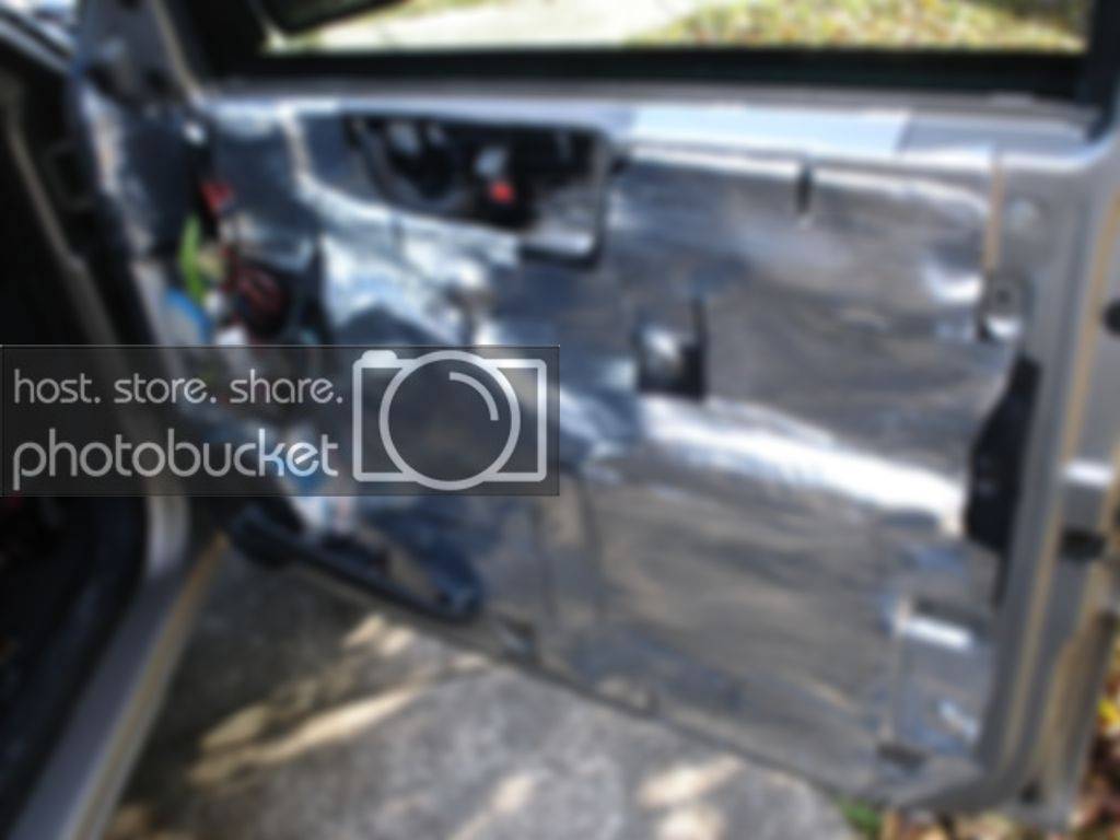

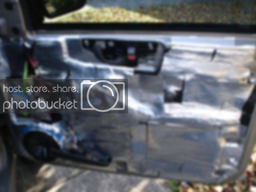

I just finished doing my passenger door inside and out with Edead 80mil. Anyone wanna critique my work and give me a tip or 2 before I start the driver door in a few mins? Go easy on me, it's my first time //content.invisioncic.com/y282845/emoticons/frown.gif.a3531fa0534503350665a1e957861287.gif
Sorry I didn't take too many pics, just the aftermath.
hope it doesn't fall off, mine did
you need to cover up all of the holes on the door

doesn't look too shabby for first time

1) clean the door first
2) go over it with a blow dryer after you roll it on, then roll it some more
3) learn how to do more cuts than in a straight line
4) cover everything, then cut out where the panel pins go into the door.
1) clean the door first2) go over it with a blow dryer after you roll it on, then roll it some more
Thanks for the tips man //content.invisioncic.com/y282845/emoticons/smile.gif.1ebc41e1811405b213edfc4622c41e27.gif
first of all clean the door with wd40
secondly go and pick up some diamond mesh and cover up those holes with little stinger screws.
now get your deadener and cut into tiny 5" by 5" squares and work your way covering the whole door and cutting the excess. discard the excess and more is better lol. There is no less is more with that haha.
hairdry and roll and repeat.
