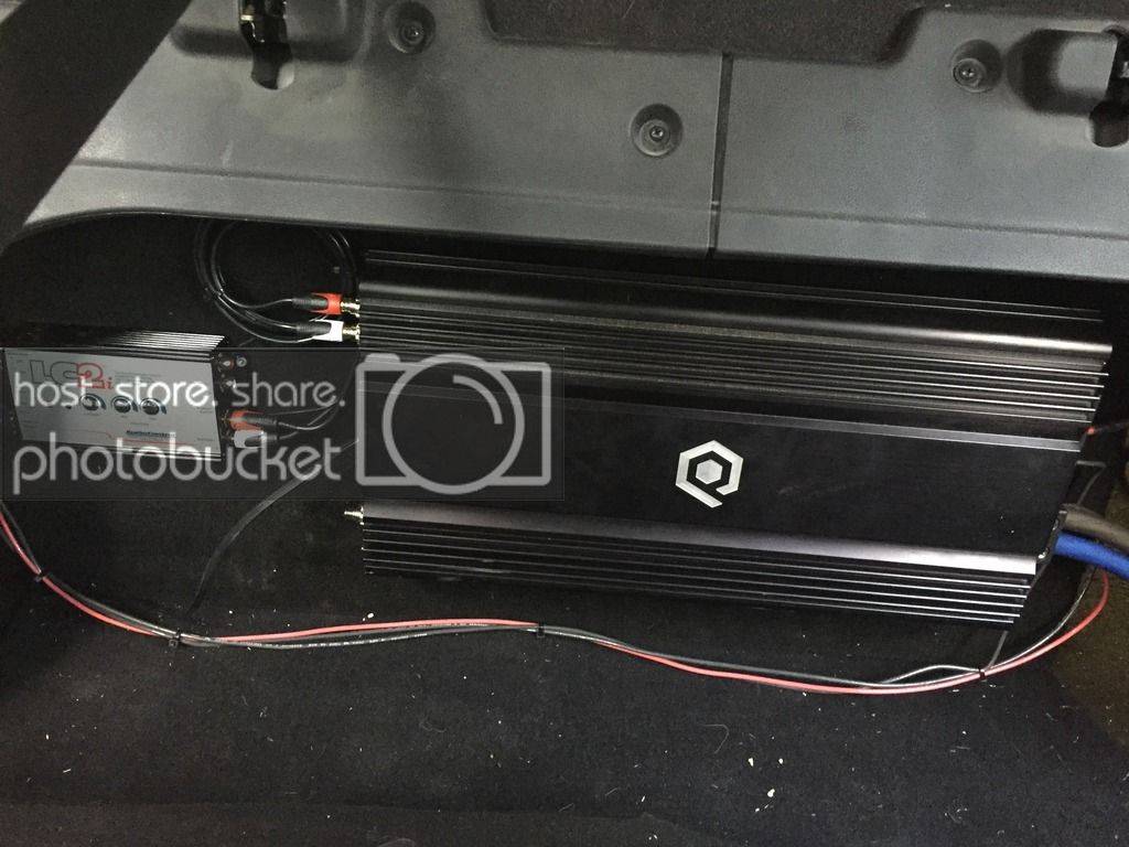

Can you post a pic of your setup for us to see how it is right now?
Box before it was finished
Sub installed
Amp setup
