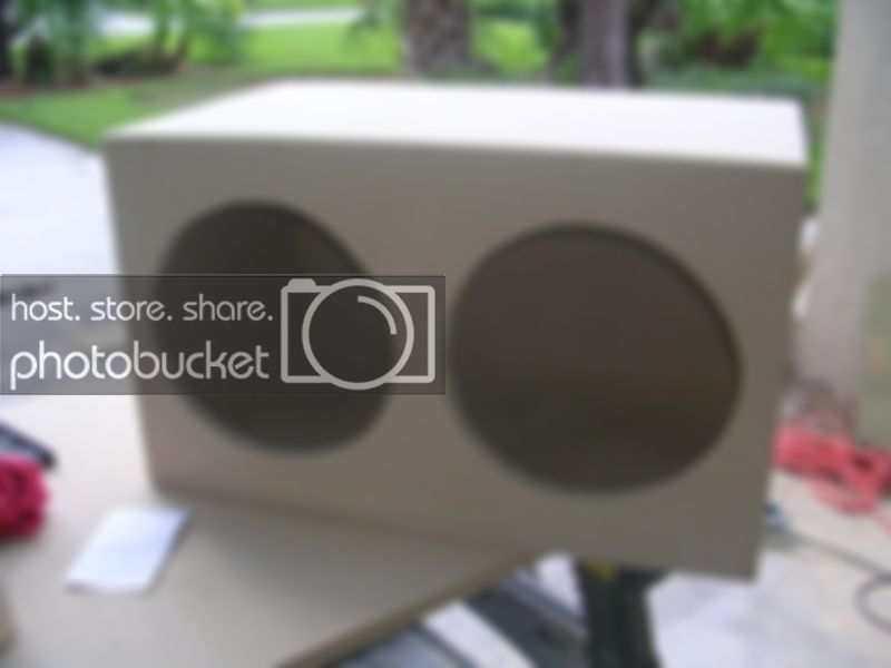

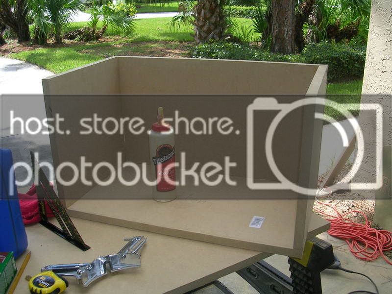

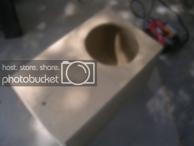

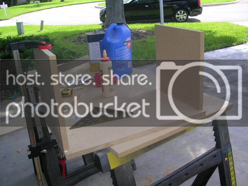

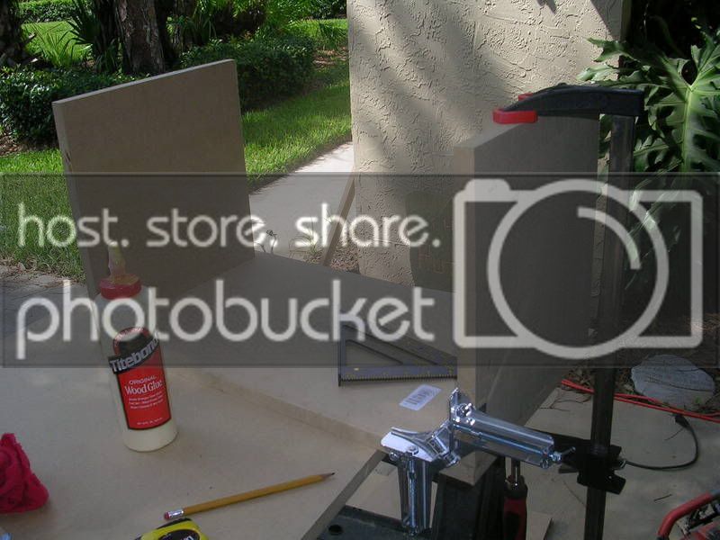

First one built. It's for NeedDirections, two 10" TC-7 hybrids. 1.75 cu ft sealed. Turned out fantastic.
Just waiting for speaker box terminals to come, then it will be getting shipped out. //content.invisioncic.com/y282845/emoticons/biggrin.gif.d71a5d36fcbab170f2364c9f2e3946cb.gif

pick up a router when you get a few extra bucks. Makes things so much easier //content.invisioncic.com/y282845/emoticons/smile.gif.1ebc41e1811405b213edfc4622c41e27.gif
No kidding. Money is tight right now, but I plan on getting one most definately.
And no the box will not be painted, he didn't want it.
looks solid. i agree on the router. you can start with a cheap rotozip and the circle cutter for it. the "sabre cut" bits cut through 3/4 mdf sufficiently. a little slow for my taste, but they cut pretty nice circles.
thats what i need to do, my holes always look jacked up and the first cut is never big enough so I have to trim it out a bit, but thats better than them being too big and wasting wood
