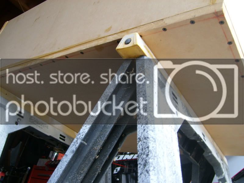

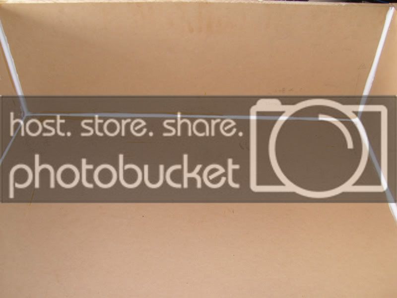

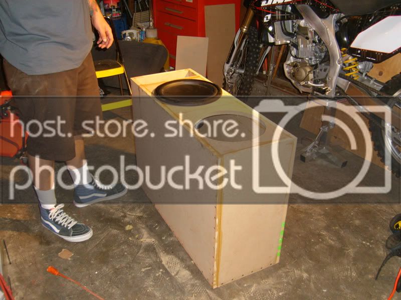

the glue does a pretty good job of sealing the box up if all your cuts are fairly straight but i still always silicone all the internal seams just to be sure its sealed up well. You don't want air escaping from anywhere other than your port.
SEAL them
And im a ported guy.
These subs want to be sealed......your hurting them running them in a choked ported box. Seal them and throw them the power. (1500 rms=)

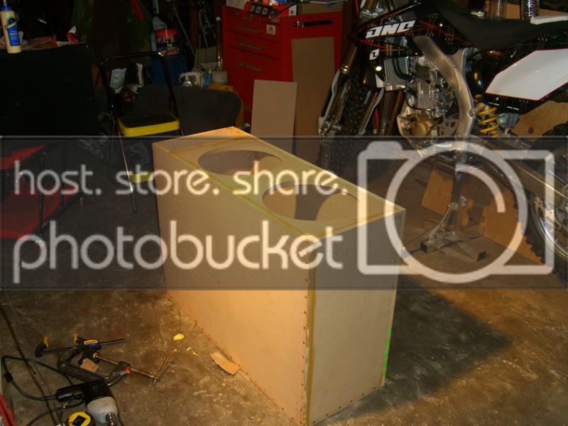

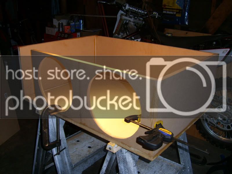

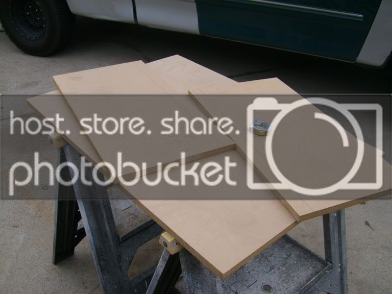

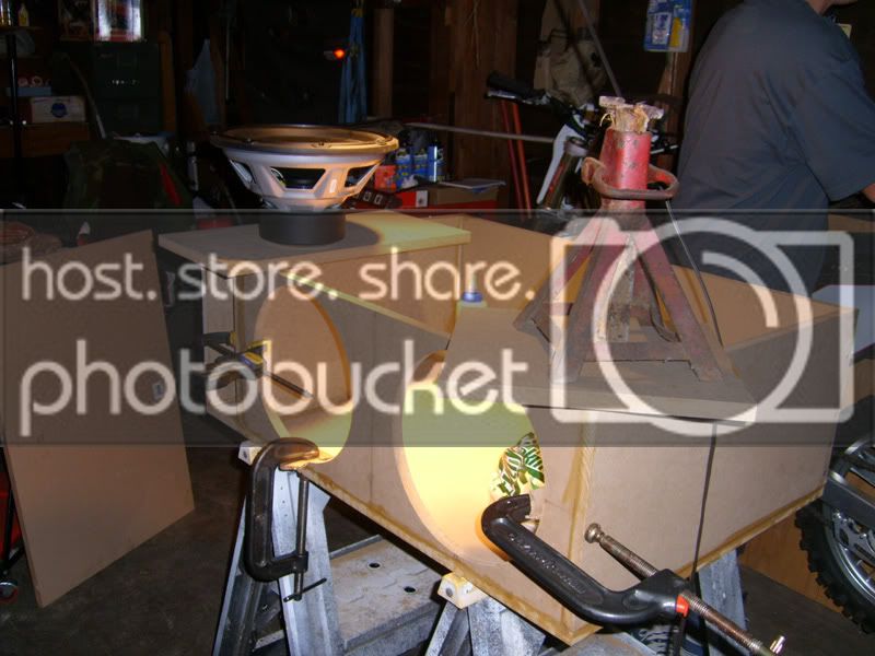

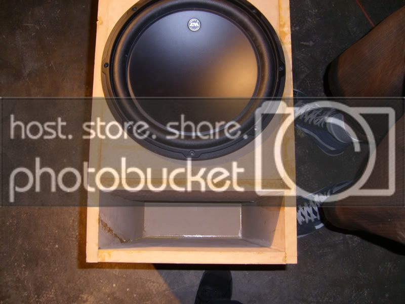

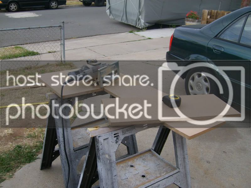

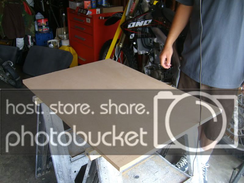

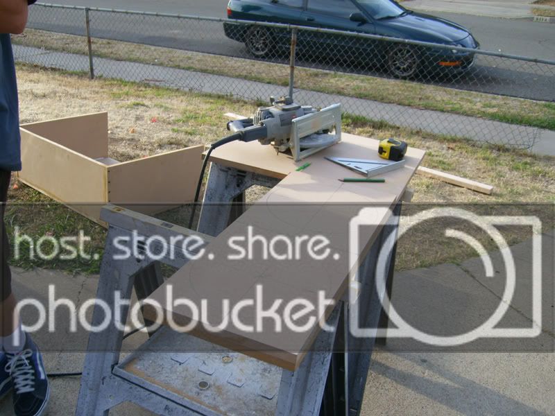

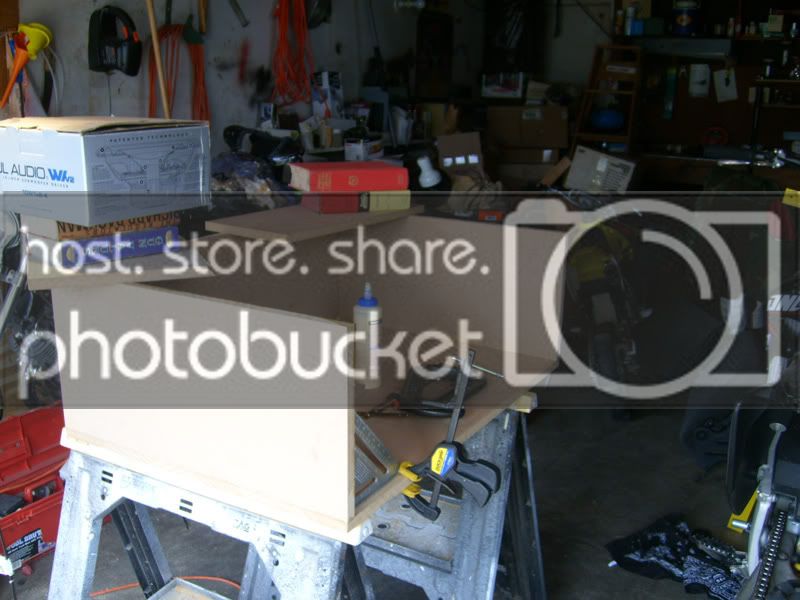

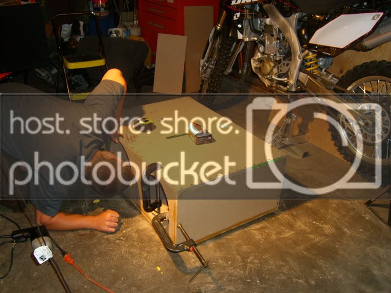

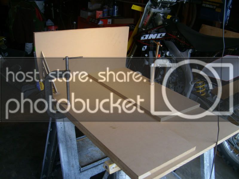

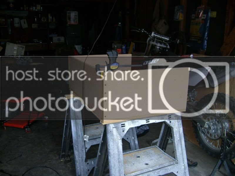

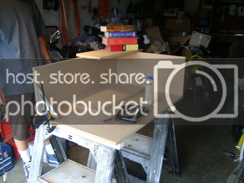

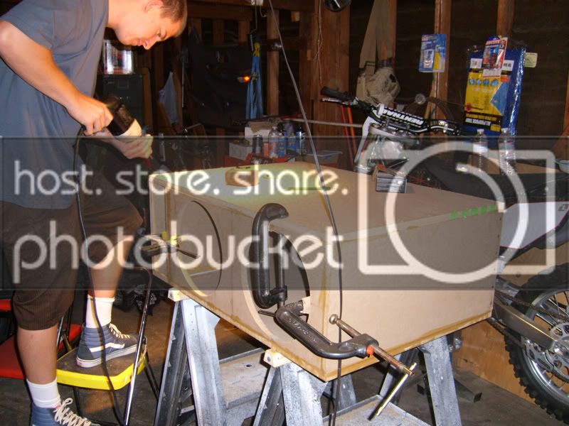

Kinda overkill on the screws and a lot of pictures but there was a lot of standing around waiting for the glue to dry and all. But im satisfied with my first box build. Just needs to be carpeted and cut the hole for the terminal.
