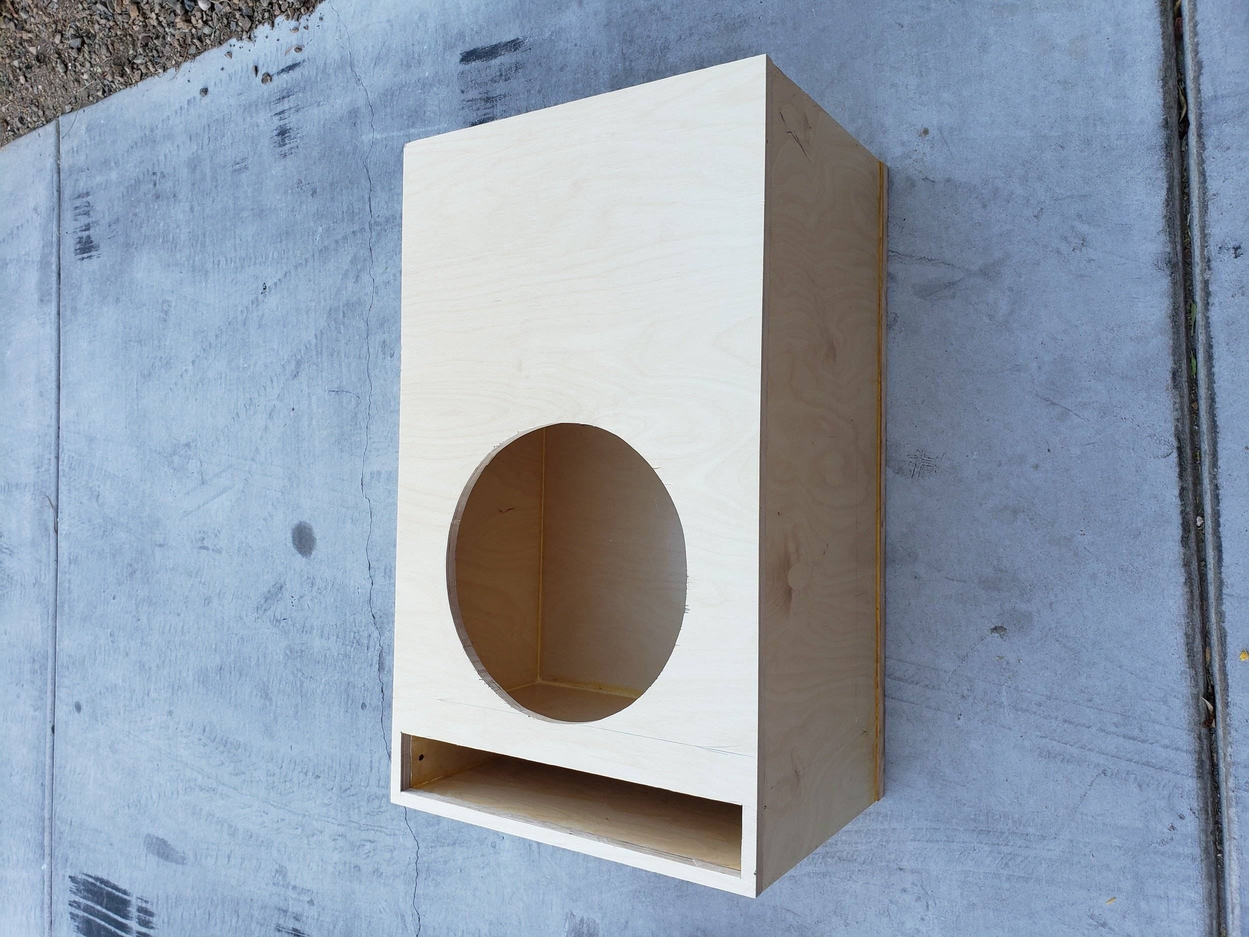

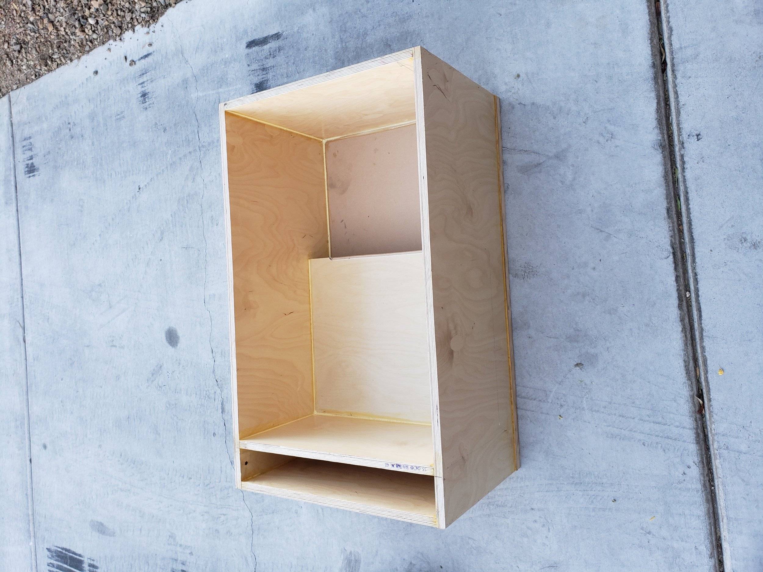

Giving box building a shot. It's not finished. Still have 45's and some bracing to install. Roughly 4.15 net at 32hz. 3/4" Birch with a 1" MDF base. Still need to do some routering to.
