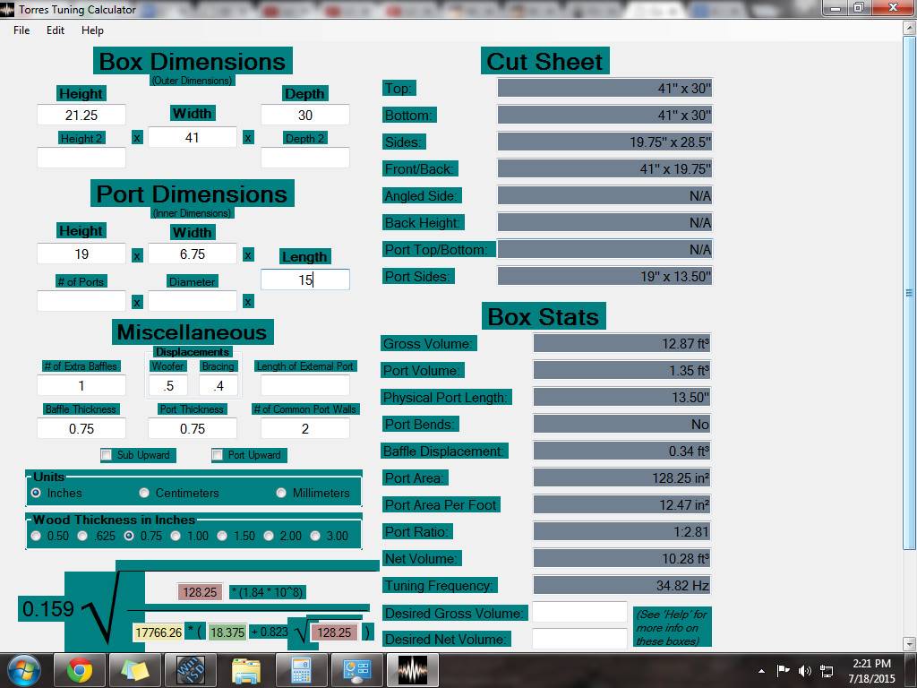

I'm attempting to use torres to design a box for a friend......he has four 12's...his max dimensions are 41w 24h 40d and it needs to be tuned to 38hz.....2.55 per chamber, sub up port back, and two chambers......this is what I came up with in torresView attachment 26553052
port area way too small.
Enter your sub's xmax and tuning into this and you'll find out how much sq inches of port area you need
Car Audio - PORT Size Calculations and Formulas for WOOFER and Subwoofer BOXES
as long as your sq inches of port area is above that, you should be fine.
