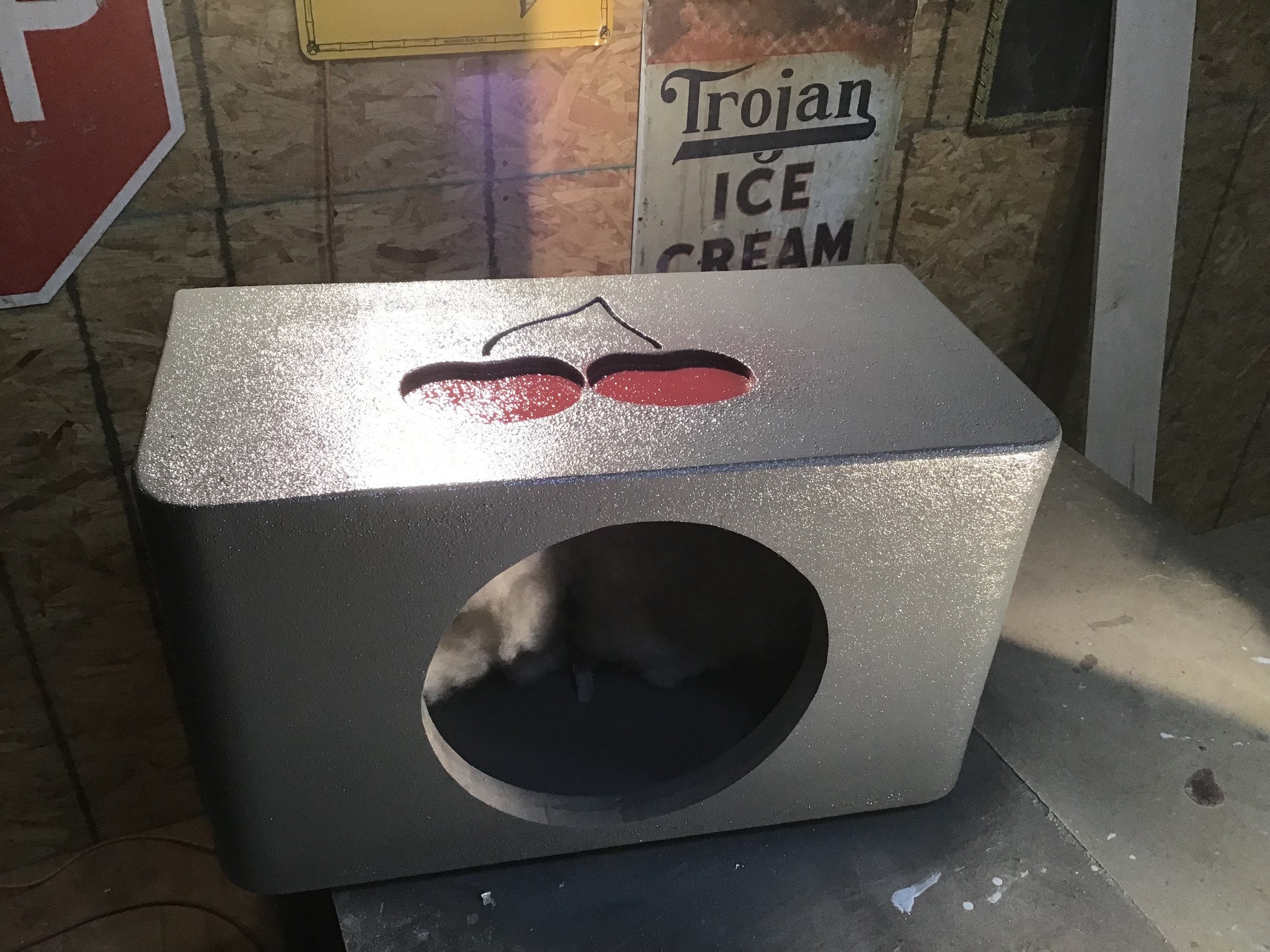

If you’re doing any type of gloss or semigloss finish, use bondo. I always use a texture of some type on mine to save time. Hiding screws with gloss paint is a little difficult. On this one I bought a little bag of texture at Home Depot that I added into a gallon of primer (thinned down), and rolled it on.. I do enclosures often, and the spray paint textures are expensive. There is a stone paint that sprays on a nice texture also. It takes at least 2 cans to spray a whole box, but it is faster and easier. You can spray any color over it that you want. You can fill the screw holes once, sand them down a bit and just spray a texture. Doing a high gloss finish, you’ll really need to do a lot of sanding and hiding seams. This one was very easy to paint. The texture hid everything basically.
