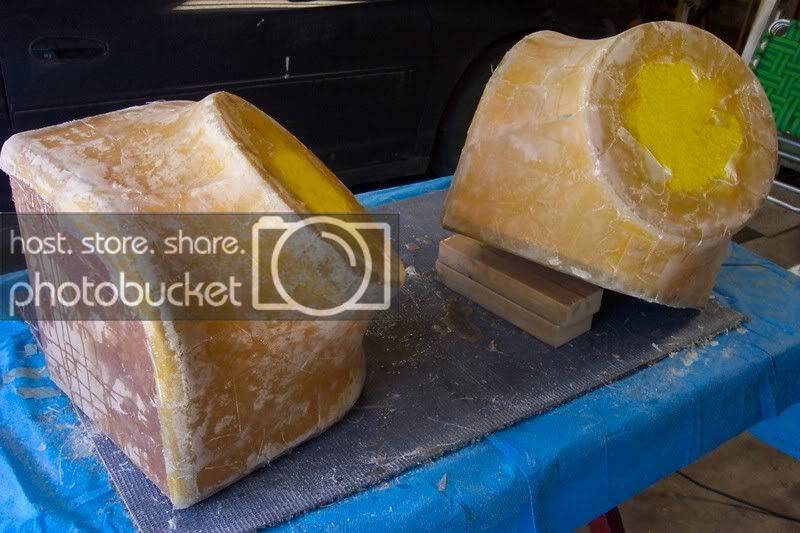

this is what air bubbles look like. all the white spots on the enclosure. (this was my first ever attempt and later sanded them all out and refilled). this was done with cloth and you can see how the edges did not mesh. every layer was moved so they are all covered but you will see in the next pic how smooth it is with hand-ripped mat.
this is what it looks like with no bubbles. the mat will actually become clear once it is fully soaked and stay clear after it has dried.
rip your mat by hand into 2" or 3" squares. it is much easier to lay down and the edges will mesh easier between pieces.
you can see here in my last piece how well it will bond mat to mdf.
