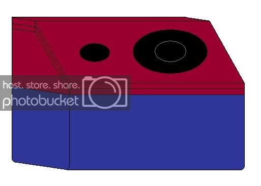

Here is the box design, not to scale. Driver on right. 6" aeroport on left.
my question is how do I join the fiberglassed bottom piece to the MDF top piece?
Also, how do I go about finding volume of total box since its an irregular fiberglassed enclosure?
thank you!
so I had a sweet idea. would it hurt to fill the fiberglass section with water? i could do that to determine volume of it and use simple math to determine volume of top portion
hmm. also is it okay to have the bottom well section fiberglass only with no mdf? strong enough?

Fiberglass only enclosures are plenty strong for any application with enough layering. What kind of power will this enclosure be looking at? If you're going to paint it in the end, I'd recommend using FG cloth instead of mat for the last 2 layers, it will help a little in the sense it will give a somewhat smoother surface to begin working with.
It would be a single fi btl 15" off about 2600 watts.
the top mdf portion would be wrapped in gray vinyl the bottom would probably not be painted
If you can(or have enough funds) get some spectrum/sludge and line that fiberglass portion in it after you are done glassing completely. Or Get some Resin and body filler and make a milk shake and do the same if you dont have spectrum
does that give added strength or better sound or something else?
hmm.. well I'd rather just layer the glass and not use MDF because the point in the glass in the well is to get extra cubes. thats why im doing this instead of completely out of MDF
