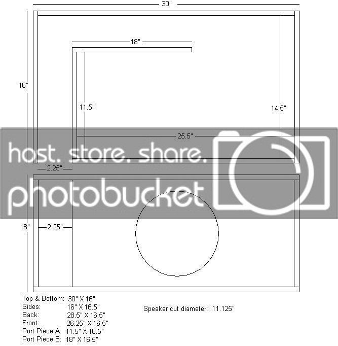

Dont waste a good sub like that on a prefab. Even though you said you didnt want to build you own it would sound so much better. And as for that box It looks way to small. SSD's move alot and youll probably have some port noise. I have plans for a ssd 12 if you would like them. Or you could have someone on here do all the cuts and drilling for you and send it in pieces for you to assemble to save on shipping
straight from scott at FI. Its for the copper coils.
yeah its the copper coils, but i cant have a height bigger than 14 inches //content.invisioncic.com/y282845/emoticons/frown.gif.a3531fa0534503350665a1e957861287.gif trunks are lame.

btw, what does it really take to build a box? i dont really know what i'd be getting into...

i thought i wanted trunk space, but once i put it in i wanted more bump, so it's dual ported for me //content.invisioncic.com/y282845/emoticons/smile.gif.1ebc41e1811405b213edfc4622c41e27.gif
just to let you know that it's unfinished and not real pretty looking, but it should work fine for your application.
but if you have the tools available i'd try to make one. it's a good learning experience and not that hard.
if you have a pneumatic brad nailer, jigsaw, wood glue and have home depot do the main cuts it shouldn't take more than an hour or two.
