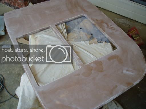

any build pics?
i'm interested in how you worked out the false floor //content.invisioncic.com/y282845/emoticons/smile.gif.1ebc41e1811405b213edfc4622c41e27.gif
Well the Ford Five Hundred comes with a floor that has a cutout that is about 3 inches deep and the shape of the board in the picture. I really was an easy project, I just mounted the amps on a rectagular piece of MDF and then cut the board in the pic and covered it with carpet and set it over the amps with little feet on the bottom of the board to lift it up flush with the tops of the amps.
