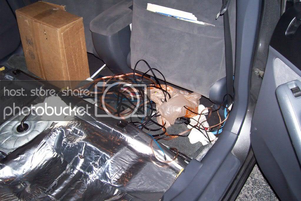

not too much got done today. added more deadening and took care of the drivers side of the rear seat opening. did front and back of that brace that rest at an angle. um, i ended up unhooking all my speaker wires and amps from the car so now i have no music. i'll have to re-route all the wires so at least now i can seal up the holes that need to be sealed.
i'll be picking up a can of Great Stuff foam and spraying in certain cavities to "plug" them up.
here's a pic of today's progress.

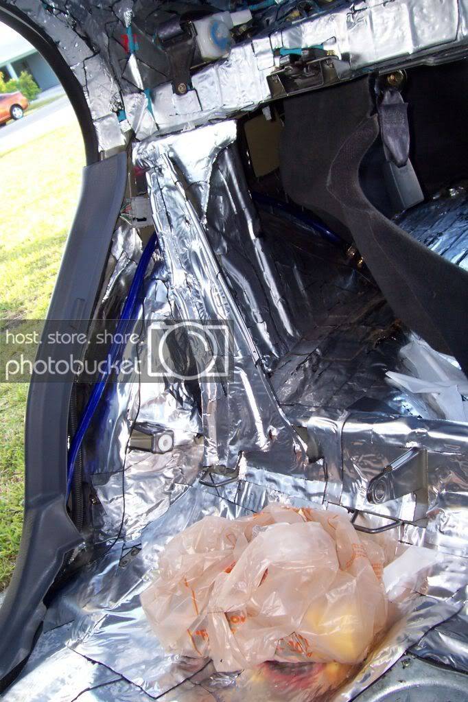

and my new rats nest.
not so bad though.

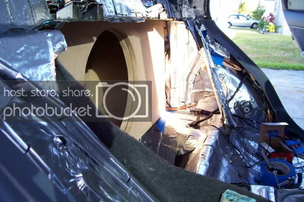

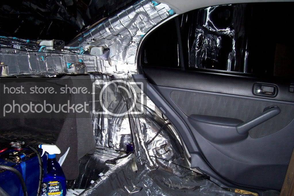

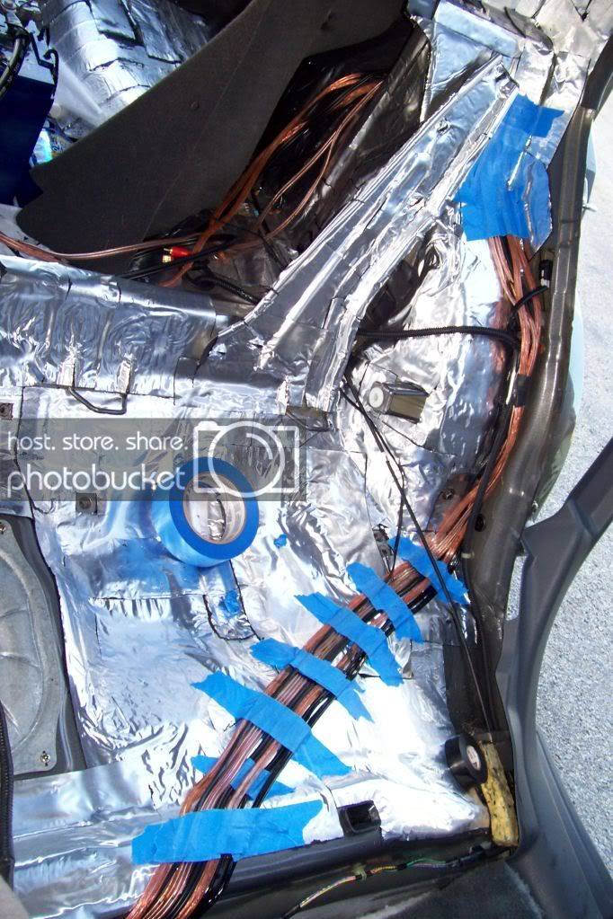

ok, a little more progress done today. laid the rest of the sound deadener. 25sqft really doesn't cover much area so i wasn't able to multi layer much of the seat floor. i did multi layer the wheel well though.

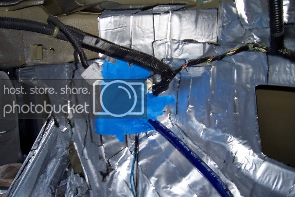

i then began to re-run the wires and clean them up a little. the blue tape is temp to hold the wires down. or i may just leave it there as there is no harm as it's just positioning the wires flat.

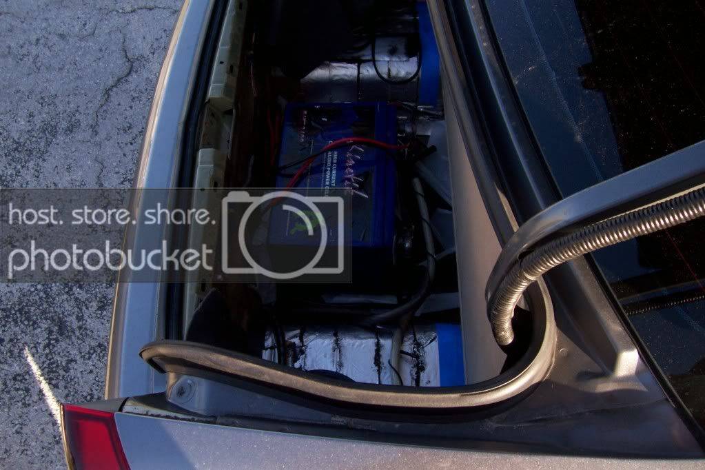

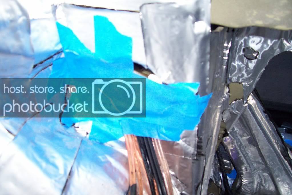

i also used a can of expanding foam to seal up a large crater where the wires ran from. there is blue tape there to contain it in an area. tomorrow i'll pull that off. i'm finalizing the enclosure plans so i can pick up my wood tomorrow and begin work on it on saturday morning. as soon as my enclosure is sitting in place i can begin to fiberglass the panels.
here's what pics are in!
all RCA's and Speaker wires run on the drivers side.
Power wire, remote, and 12v feed to voltage meter run on the passenger side.

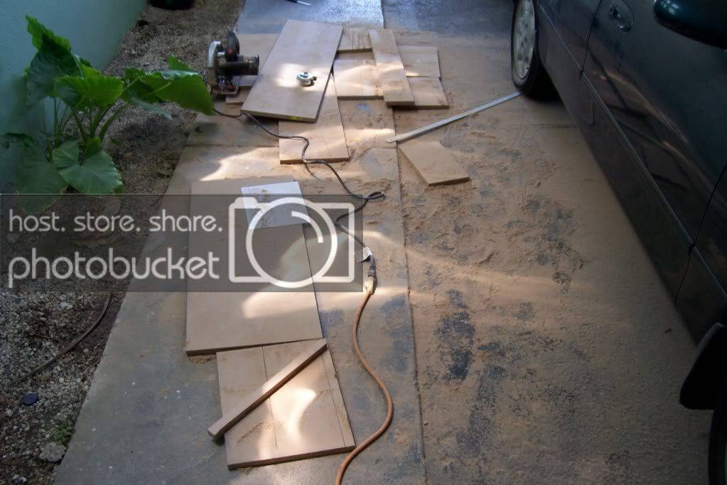

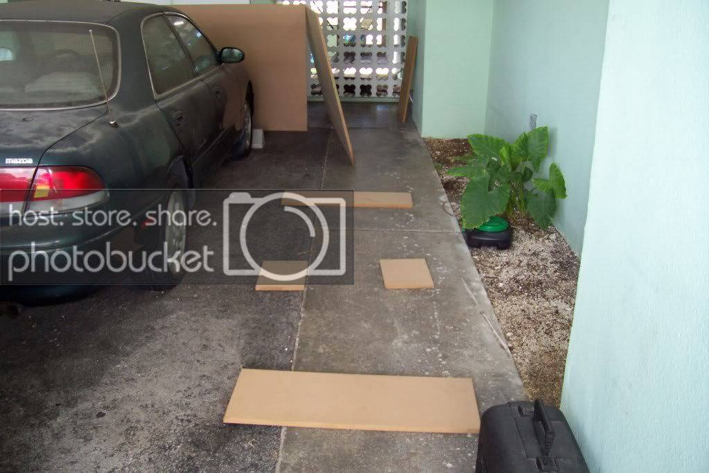

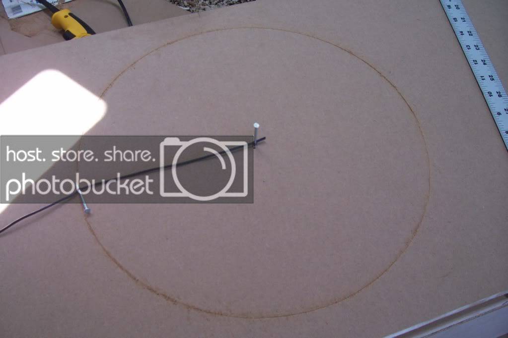

well this is my set up work station. lol

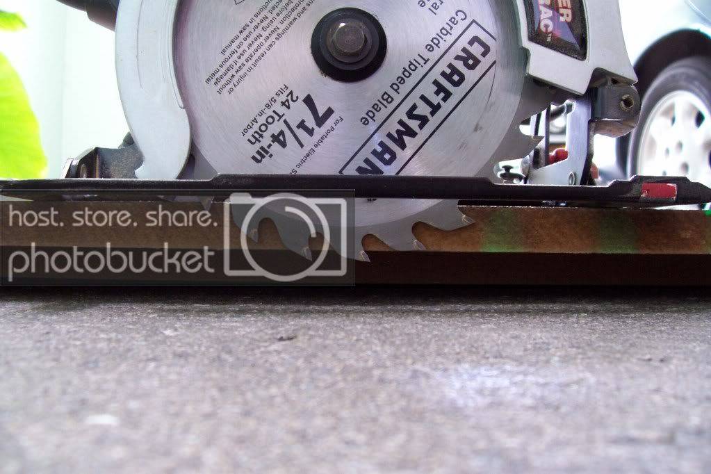

setting the circular saw.
the half way there mess after 1 sheet
my mounting hole guide tool

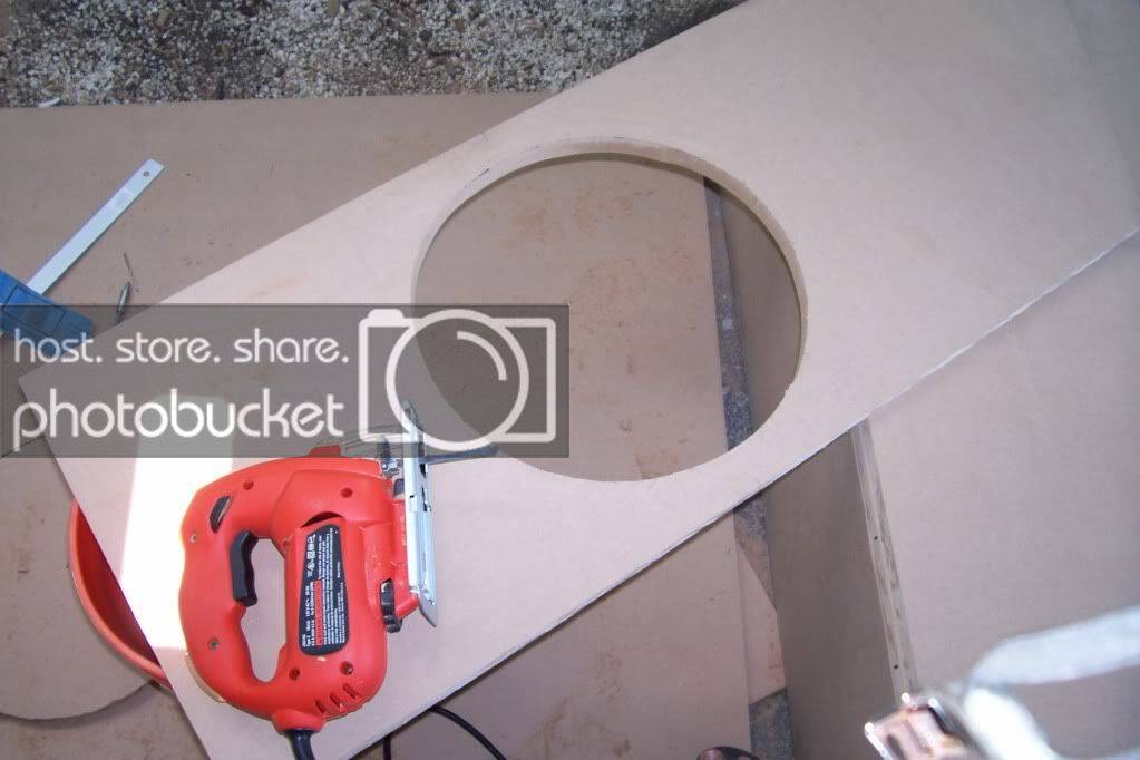

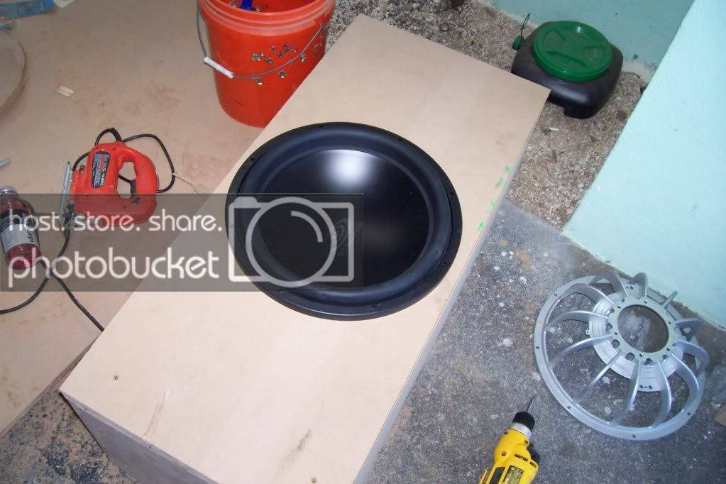

**** yo router! Jigsaw FTW

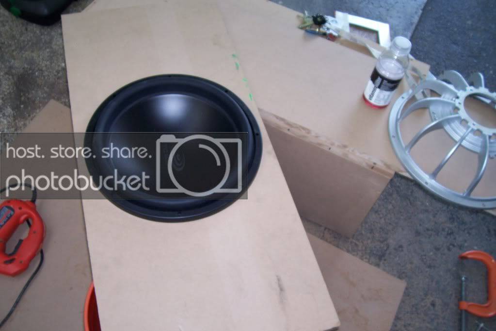

test fitting the top assembly(glad i didn't have to lug the whole motor around)

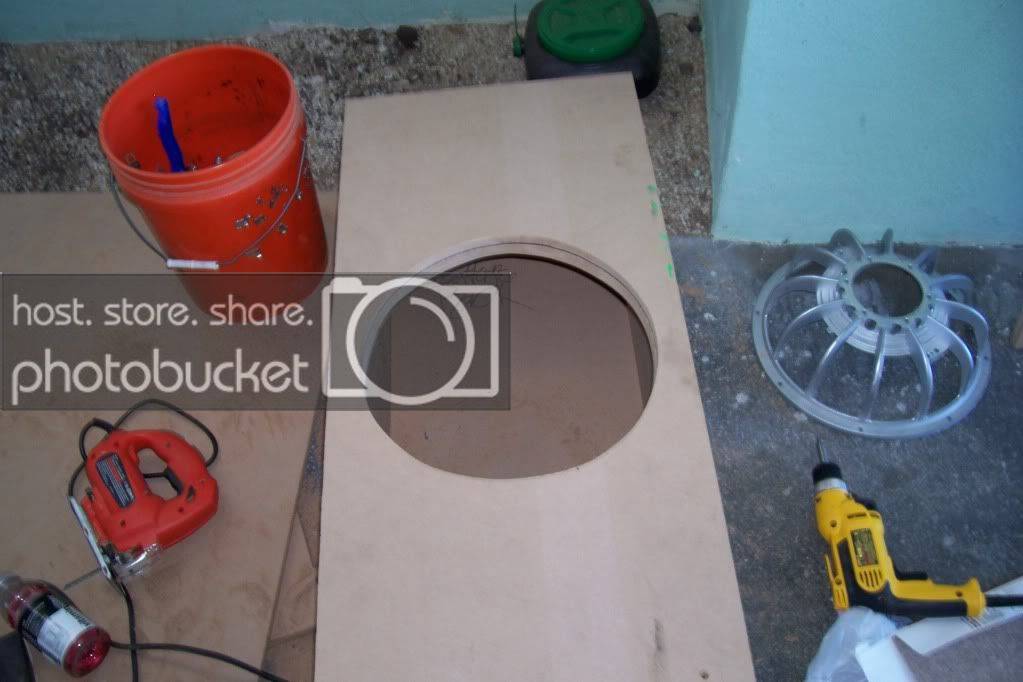

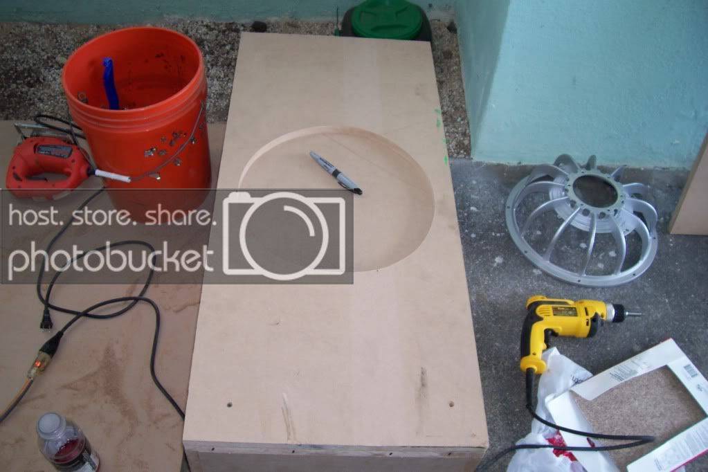

lining up the top baffle to the 2nd baffle
cut 2nd mounting hole

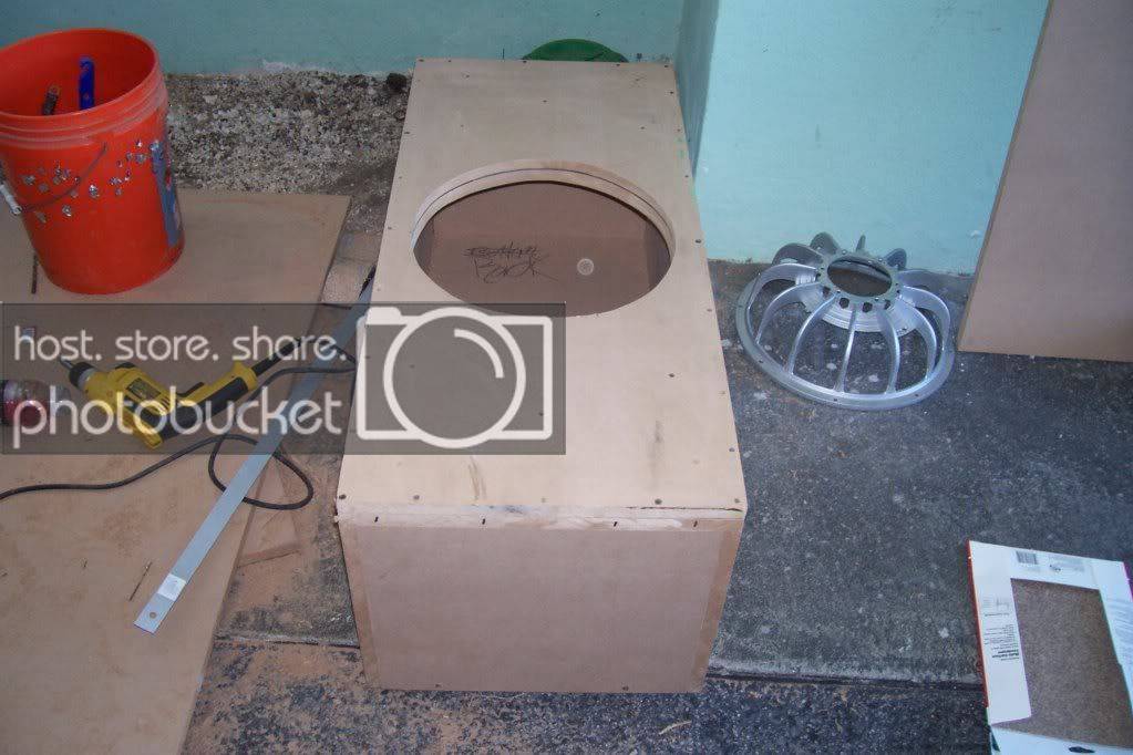

screwed the second baffle to the first.
test fitting again

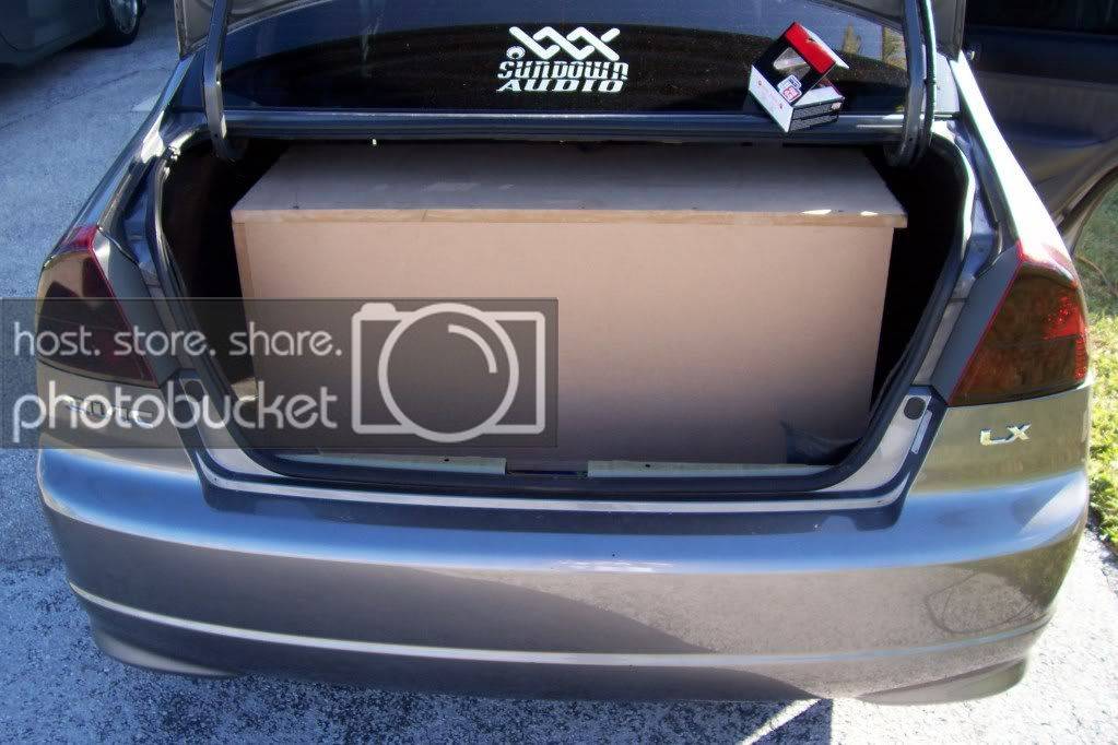

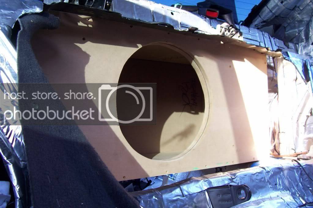

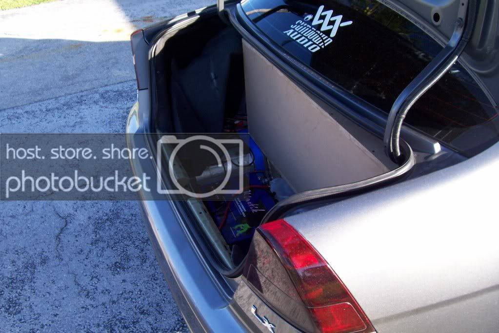

now at this point, the enclosure is nicely set and all screwed together with a few screws. the reason why i screwed it all together was to test fit it into the trunk so i can see if i needed to build it in the trunk ot not. PLUS, i needed to set it in the right place in the trunk so i could find out where i needed the port opening on the top of the box being that i have to line it up with the speaker openings on the rear deck.
well, upon a FEW tries at different angles the whole box will not be able to go into the trunk as 1. what sucks is i have to break it down into 2 pieces which i already have figured out. after sitting it in the trunk and properly sitting it while it was partially re-assembled i took a few pics to give you guys an idea of where it will look like(sort of).
front view
rear view

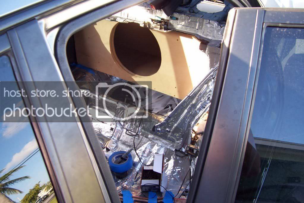

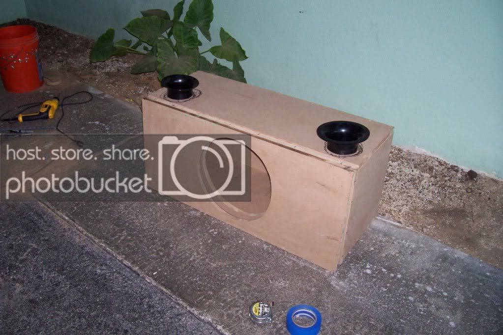

well after i dis assembled the needed to remove parts i then cut out the 4" holes for the pipe. i have to say it is a tight sitting for these flared ports. i think the mounting high may have to change a little when it's inside of the car. i'm going to have to wait till the box is in the car and i can cut up the rear dash panel.
here's what it somewhat looks like overall. the ports will be higher but this just gives you a general idea.
