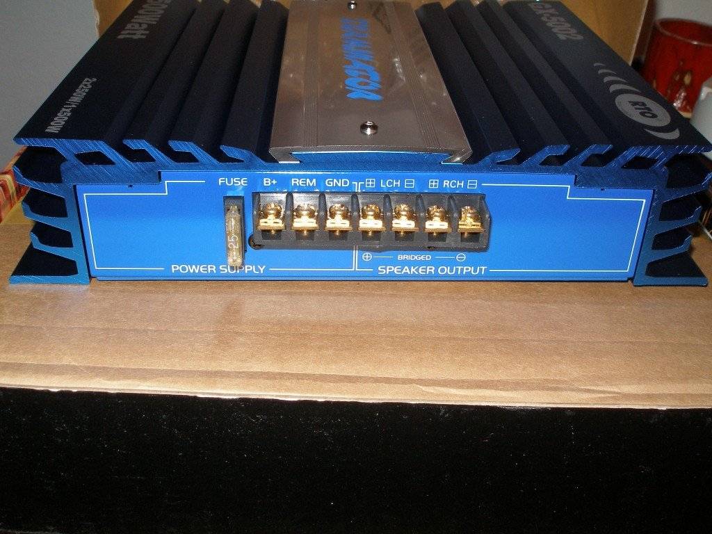

How do you have the sub wired to the amp? i.e. which amp terminals exactly?
You should be wiring the sub only to the two terminals marked "BRIDGED" in this picture...
1657471

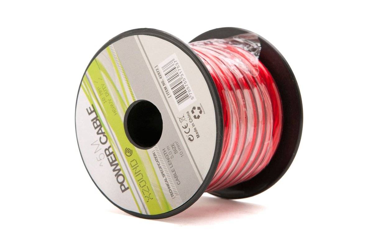

I'm using around 1 meter of
this cable for ground and positive.
According to crutchfield table it should be okay, but what's left? I changed wiring spots, AMP does get power and ground, but amp does not output stronger signal for the speaker.
Should I buy thicker cables? :/
