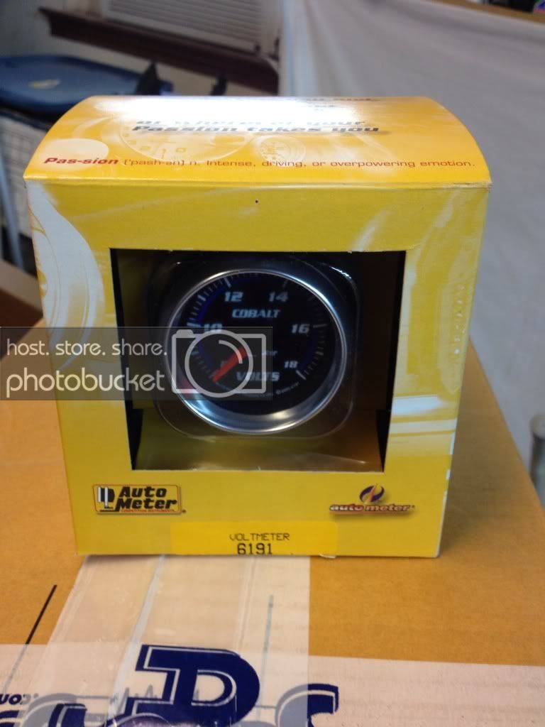

Accessories: Autometer Cobalt Volt Meter 6191 ($111 shipped from eBay)

Autometer Volt Meter, yet to be mounted. it will be mounted in Dash bezel next to head unit where the factory ash tray was.

Also, what makes that volt meter so expensive?
just a 2 speaker pod in the door, nothing special. the volt meter is a 360 degree full sweep meter. most of the ones you'll see that are like this only have a 90 degree sweep or 270 degree sweep plus it lights up a pretty blue.
