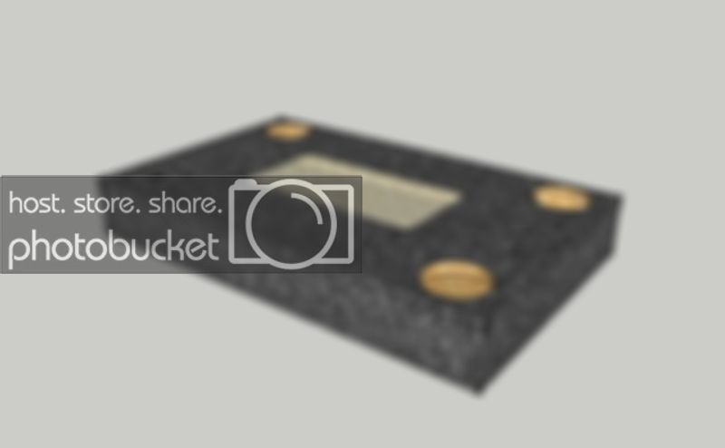

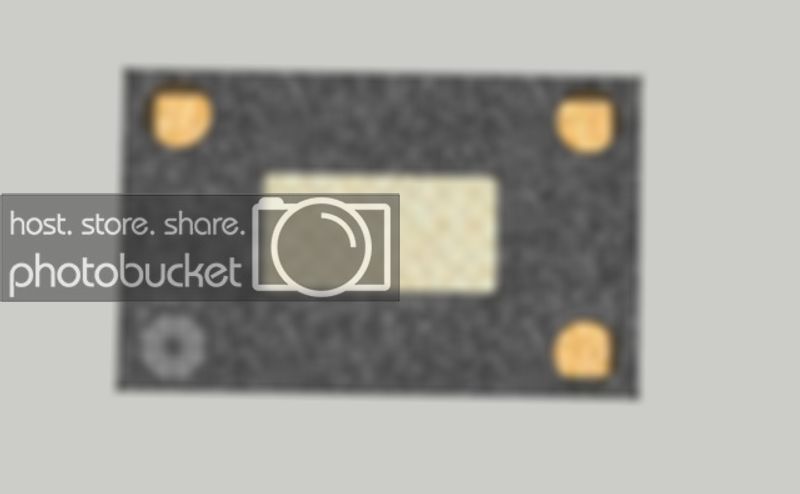

You can see that I drew a outline frame which will be made of 3/4" or 1/2" MDF double baffled and painted black.. At the corners there will be square holes for the fans to fit into..
I want to put at least 1/2" plexiglass on top of the frame, but I plan on making the inside edges of the frame recessed so that way I can flush mount the plexiglass..
After all this, I will still be able to show off my amp and still have cargo space..

Heres a rough ideas of what im thinking... Also cant wait to see the build log //content.invisioncic.com/y282845/emoticons/wink.gif.608e3ea05f1a9f98611af0861652f8fb.gif

I sure do like your design.. but I would like the plexi to be a bit bigger if possible? 12" x 24" is not cutting it for me? I think I would like maybe just a tad bigger?
and no I dont plan on blocking my port at all.. my goal is to have everything flush right below the port or maybe line up to the port equally if I have to..
I am really digging your design you just made for me.. but I would like to make the plexi a bit bigger, do you think thats possible?

P.S. holy batman, never knew that plexiglass is that expensive.. WOW! I guess I will have to ditch my original design and maybe start working around the design CJL made for me.. I definitely do not want to use mesh or anything like that since it defeats the purpose of my idea.. I wanted this space to be "store-able" which I can just throw my stuff in the back without worrying about hitting the amp or falling thru the mesh
