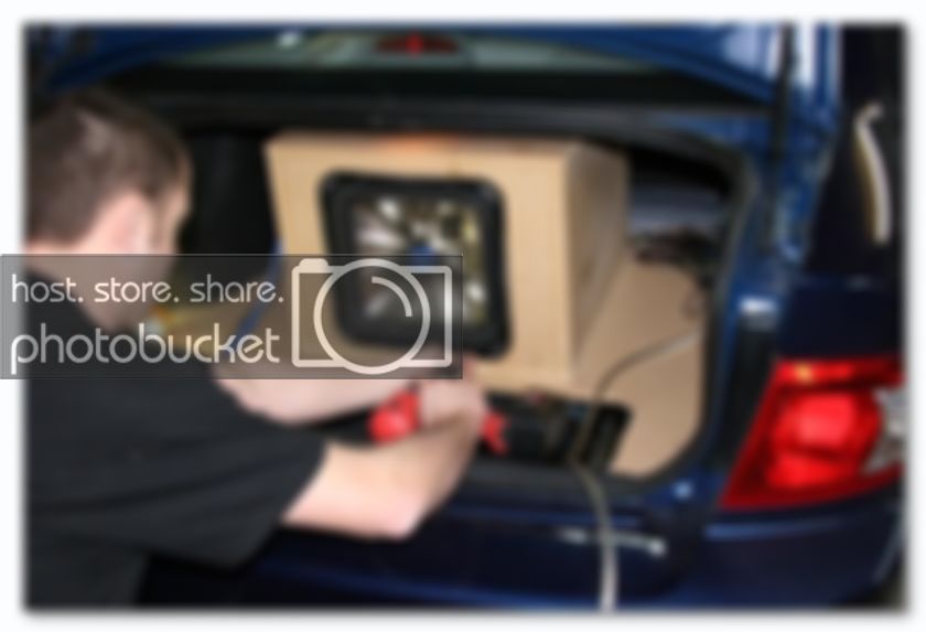

I built mine seperate from the false floor.
THen attached it to the false floor via bolts through the bottom board of the enclosure. I still have full access to my spare //content.invisioncic.com/y282845/emoticons/smile.gif.1ebc41e1811405b213edfc4622c41e27.gif
