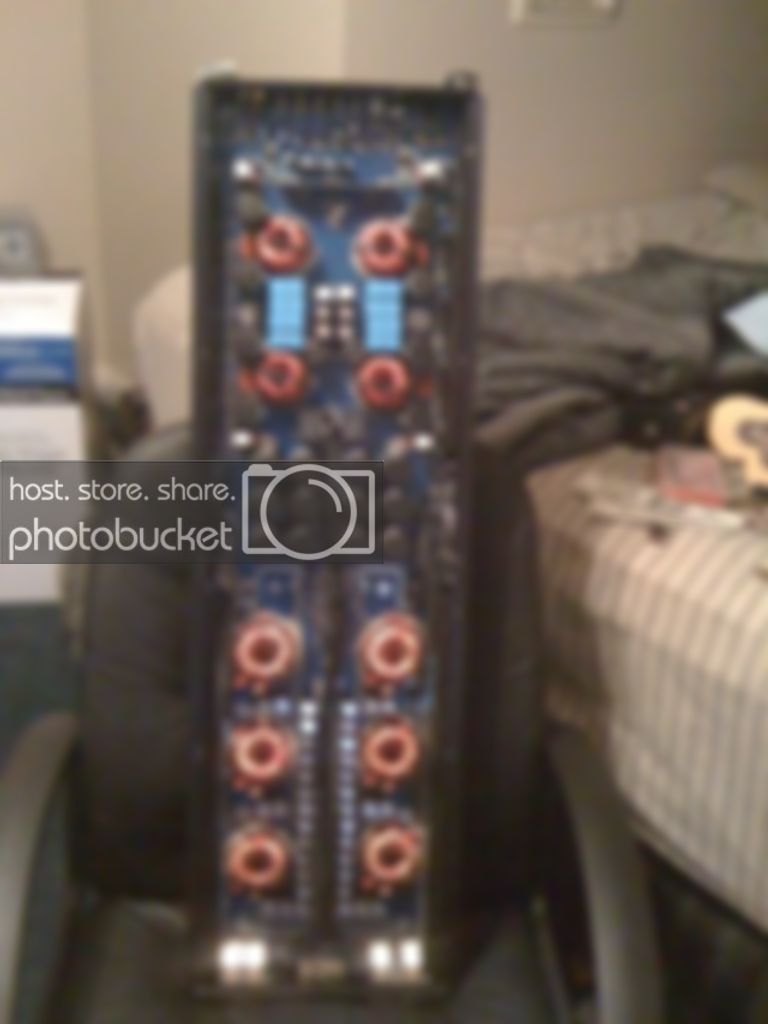

No fets have been blown I was told that the output drivers are shot, amp goes into protect when powered on.
I'm letting this go for 400 shipped or trade straight up for a saz2000d
It was previously repaired by me for blown power input traces right after both positive terminals. I jumped over the traces with 2.6mm thick copper bar. Really a beefy looking repair that I would be proud of fashioning. I performed durability testing on site with a one ohm resistive load bank for twenty minutes without failure. I suspect the output driver is blown, the amp is notorious for this and it fits the description of symptoms. Still a hell of an amp.

I had one of my old 5k's that just went into protect every time I turned it on. My local tech has been doing alot of zennon repairs and found the issue to be in the lil board that holds the protection circuitry.
Fixed that it worked fine after.
Just a lil info Good luck with sale! 300 is a steal knowing it could be a 100 dollar fix //content.invisioncic.com/y282845/emoticons/smile.gif.1ebc41e1811405b213edfc4622c41e27.gif
It may be the case. //content.invisioncic.com/y282845/emoticons/smile.gif.1ebc41e1811405b213edfc4622c41e27.gif I'll find out soon...
That little board is also the output driver board by the way.
