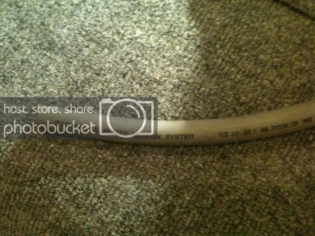

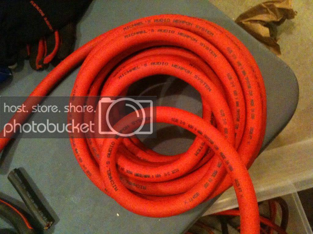

Let me look in the morning, but I know I have some 1/0 Knu Kolussus, 2/0 Trystar, etc. The only thing is that the Trystar has custom labeling that reads "Michael's Audio Weapon System...I love it //content.invisioncic.com/y282845/emoticons/smile.gif.1ebc41e1811405b213edfc4622c41e27.gif
