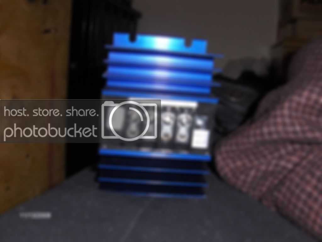

My teammate has had to send his EA alt back 4 times so far and he has only had it for 1 year. Just got sent back Thursday, threw it on, and he is having the same issues......charges to 14.1v then all of a sudden drops to 12.0v. Wait a little bit and it spikes back to 14.1 - all sitting at idle with no load (other than the car running)!
Wonder if Nate had a batch of bad voltage regulators? Regardless, I now know where "Excessive" came from - EXCESSIVE returns!
X2 pawty
I have an Excessive Alt. And I know Nate does not give good instructions on how to wire up the regulator.It took me a while to figure out what he's missing.The 12v relay on the positive wire.
The one I am talking about is internally regulated........so maybe he doesn't have instructions himself //content.invisioncic.com/y282845/emoticons/wow.gif.23d729408e9177caa2a0ed6a2ba6588e.gif
yea for sure,, it deff worked,, and i ask nate in an email how to hook it up to make sure i got it right,,
The POS needs to be connected to a 12 volt IGNITION source. NOT constant battery, it must only have power when the vehicle is running.
The NEG must go to a good ground source. It will charge at 20 volts if it is not gounded good !
The FLD goes to the brown wire coming from the plug in the alternator.
The STATOR goes to the blue wire coming from inside the alternator.There is a small white screw on the top of the regulator, down in a hole, this is where you adjust the voltage at. Turn it left to lower the voltage and right to raise the voltage
nothing about relays,, man i tell you his shits gonna go down hill quich if he doesnt get on point
