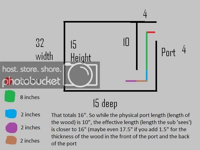

physical port length is the length of the wood. in the first one, the port does not need to bend so therefore it's the full length. in the second one, it has to bend, so it doesnt need to physically be as long as you have entered in the box. somewhat similar to this:
caption should explain it. but the physical port there is 10" long, while you're getting a longer actual port length (the small purple length is end correction of the port)
That still doesnt make sense to me. So if i need a bend in the port, then my piece of wood needs to be smaller than if i didnt have a bend?
I think what he is getting at (if I understand correctly) is that the physical port length and what the woofer actually thinks the port is are two different things and he is accounting for the little extra length you "theoretically" get in certain situations............... Right?
that is exactly right. if you look at the diagram i posted, the physical length is 10", yet the *actual* length is longer (measured down the middle). if you made that box say twice the size with the port staying the same, then the curve in the box would not technically extend the port length since it's much further away. it'd be just 10" (minus end correction). you wouldnt have that purple and brown length measurement added into the port length. so the port length is the same, just the material needed to make the port is different.
