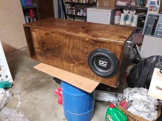

I'm currently running a T-line tuned to 34Hz. Will play down to 28Hz and upwards of 90Hz. It's a very bandwidth enclosure. Sub is a DC Audio m3 8
So would your box be a modified horn, because it has the chamber behind the sub? From my elementary understanding, doesnt the parallel wall directly behind the sub load it with air and create many resonances? Beautiful finish on that box, what kind of wood/stain/sealant/wax? What's the box underneath the subs? Mid drivers in an enclosure?
No. It's still a T-line. That chamber you see is just a void area that needed to be filled to get the correct "volume" and maintain the necessary width/length for the super long port. I used a stain from Lowes called English Chestnut. Something not too light or too dark of a finish but in between. Once applied, it's the polyutherane that really brings out the shine and colorness of the stain. That "box" under my enclosure is where my amp is...
