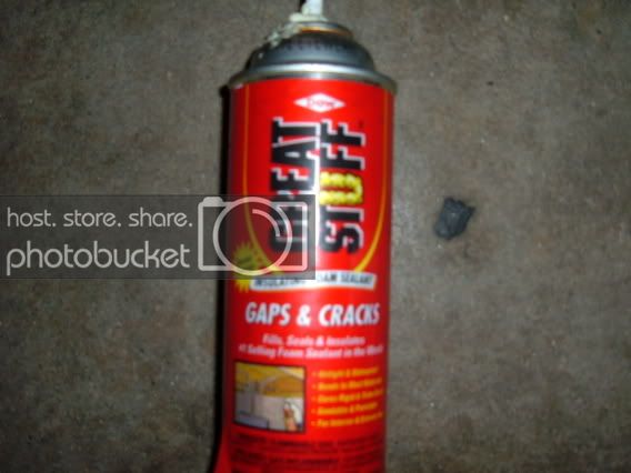

hey there people....ok first off i get tons of ratteling from the bumper whenever the bass is on(even low volumes)...i already took off the my plates and frames and its still sounds like poop....
so i was watching monster garage and they had this foam that expanded when mixxed with another liquid...so i got this idea, but i want to make sure of it first....
can i pour sum of the foam into the bumper and let it expand and have a little hole at the bottom to let the extra foam out....
or take the bumper off and put sum second skin and all that poop???
That stuffs awesome.
Yes,it will warp the sheetmetal if too much is used. I put some in rear trim panel below the rear glass of my 78 gran prix an it warped the hell out of it.The next morning I came out and the stuff was oozing outside of the car.I used way too much.Go SLOWWWWW.
then why doesn't the can burst? //content.invisioncic.com/y282845/emoticons/smile.gif.1ebc41e1811405b213edfc4622c41e27.gif
has to be exposed to air to activate it, i reckon
after u use it, and the little bit that is at the tip of the dispensing hose gets hard, u can snip it off and the part that was sealed off inside the tube is still soft and ready to spray
and don't let it get on anything, cuz it doesn't come off. skin too //content.invisioncic.com/y282845/emoticons/wink.gif.608e3ea05f1a9f98611af0861652f8fb.gif
