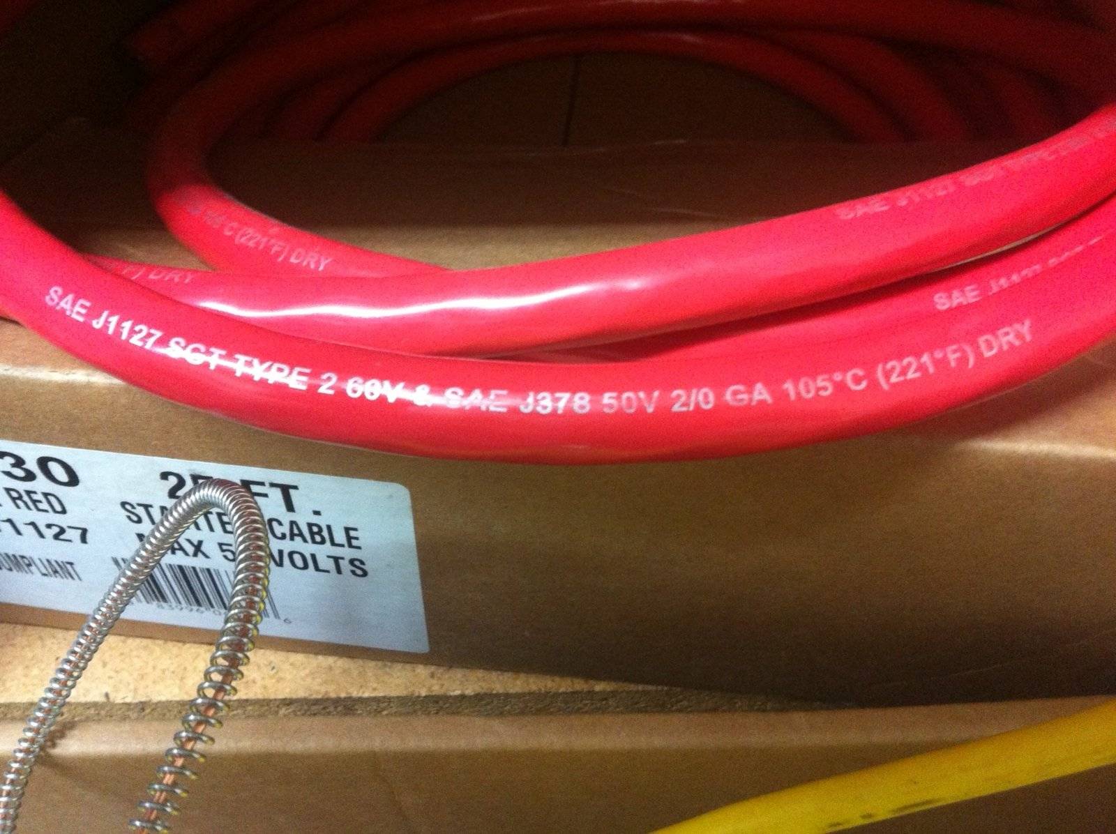

So a friend of mine works at a parts store.. They sell 1/0 2/0 3/0 and 4/0.. It's labeled as 'starter cable' the 1/0 is like $6 a foot.. he says its ofc, extremely good wire. It's true 1/0 it looks great.. On the side of it it says "Sae J127 Type 2 60v & sae J378 50V 2/0 Ga 105c (221F) DRY"
Has anyone ever tried to use this for audio? I was thinking about getting the 1/0 from him.. The store sells it for like $6 a foot or something.. but with his discount he can get me it for $3 a foot.. All I plan on using this for the big 3.. Should/Could I use this stuff?
thats low voltage 50-60v rated cable, which is high enough for us, the jacketing on the cable is not going to be as thick as other normal wire, as long as the 2/0 is true to its word it would work fine for the big three, just keep it free from any pinch points or places to damage the jacket
I'll probably use heat shrink on it. My biggest concern was the voltage on it like you said, and if it would be okay to use under the hood. Using heat shrink brings me to my next question. Running 1/0 from bat to trunk.. Is heat shrink necessary?
