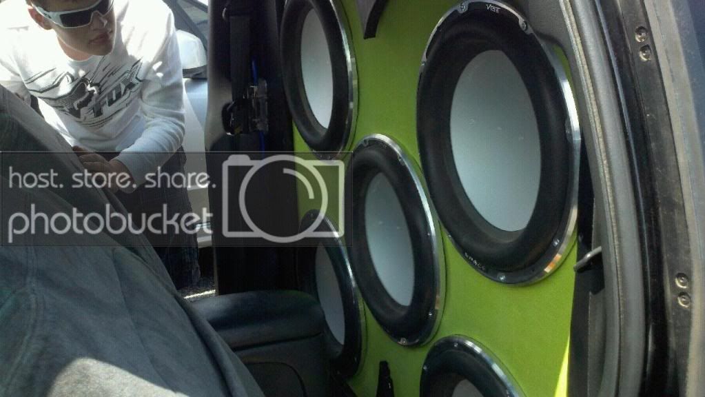

thats deff different, would like to see parts.
a 540oz magnet with 4" coil is a ss xxx,tsns,tc 4hp motor. i see it has gap cooling though. why such a low bl with that much motor?
wanna see the coil cause no coil except a armored coil will handle 6500 rms, clamped...
If the specs are legit the motor force factor is extremely high as the DCR is 1.0 ohm listed -- motor force factor would be 420.
((BL^2/Re)/MMS) is 0.87 -- so a very nice SPL driver.
The TC-5200 has a Motor force factor of 409 and a ((BL^2/Re)/MMS) of 0.79
Assuming both spec sheets are accurate... should do better on SPL than the TC-5200 due to the lower mass -- has similar motor power.
