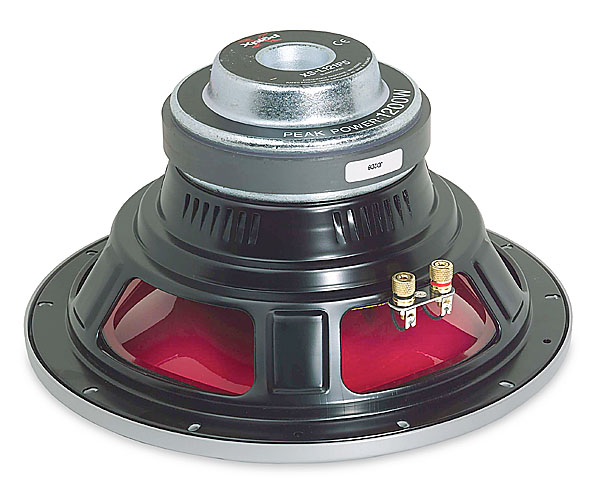

THE SONY!!!!!!!!!! haha yea right i got a HC //content.invisioncic.com/y282845/emoticons/smile.gif.1ebc41e1811405b213edfc4622c41e27.gif :) //content.invisioncic.com/y282845/emoticons/smile.gif.1ebc41e1811405b213edfc4622c41e27.gif
My baby
The basket on the XXX and Brahma look exactly the same.....
