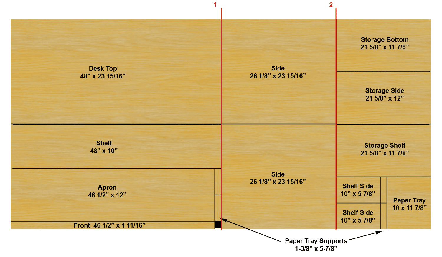

What would I need to bring to home depot/lowes or wherever I get the cutting done, the entire sheet for the box?
Just give them the cut sheet and they will dj the cutting. Buy the mdf or ***** there and have them cut it that same day.
okay so on your end, you have 48 x 96 inches. You'll be playing tetris planning on whats the best course to cut your wood because if you run into an employee that is not so skilled at planning efficient cuts, you'll have to be the one calling the shots.
I was thinking this was be the best fit
