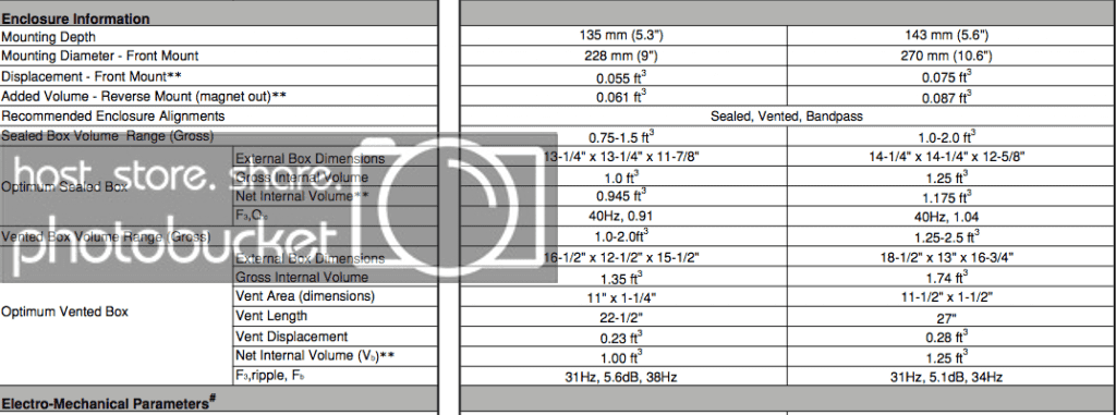

In the manual it recommends this:
Its the specs on the right hand column for the 12"
was wrong link @ 1st...... 2 is way too big......srry since you will be close to rec power just build to rec specs 1,25 ish tuned to 32
