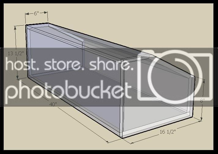

here are my dimensions in my trunk of a 00 mustang. i want it ported.
13.5 Inches height at the front, the highest it can be. its 13.5 inches high for 6 inches deep into my my trunk, then it decreases by .5 inch for the next 10.5 inches to a finial height of 8 inches.
it can be up to 40 inches long
and 16.5 inches deep into the trunk.
i might allow longer if necessary but i'd prefer not to, and this is for two 12's who need 1.5 cubic feet each ported.

You might want to make sure you can fit a 40" wide box into your trunk...I realize you have the width but does your trunk open that wide? I just built a box for a friend and ended up having to pull the back seats and do a few other things in order to get the box to fit because the trunk didn't open big enough.
You get 3.43 before any displacements, so after subs and port, you won't have 1.5 for each of them.

you know what your right, i didn't even think about that, and i wouldn't be able to pull the seats out and its a drop top, i have a extra wall between the seats and the trunk, ill have to rework the dimensions.
Any build worth a d*mn you have to do an in-trunk build for Mustangs... it's ridiculous how small the trunk opening is.
