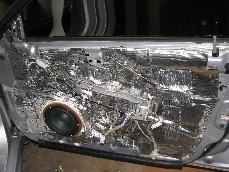

my doors before
i cover 100% in two areas.
1. inside the door
2. on the face of the door
i encased fiberglass batt insulation in 1mil PVC
and secured it to the outer door skin for the entire surface area of the door skin (in 3 rows)
then I cover the large hole(s) with a panel (wood or aluminum sheets with deadener preferred)
