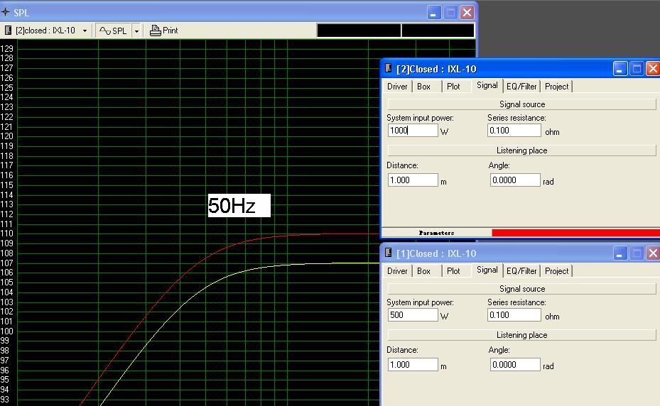

Ok, pic 1 has identical drivers in identical boxes in identical environments - all you see is one curve colour for now since they are well, identical:

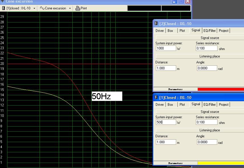

Pic 2 shows one driver (yellow) having 500 watts applied, the other (red) 1000 watts. According to the OP the one receiving 1000 watts should be louder, and of course it is:

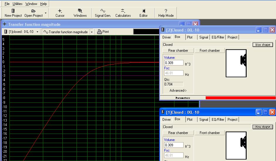

Pic 3 shows the difference in displacement between the two - red of course producing more displacement and therefore more output. So if the displacement is the same so will the output:
