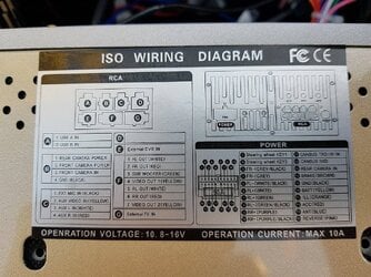

Next step is figuring out what goes where in the back of the stereo.
We have three cables coming from the subwoofer: REM, and standard black and white phonos.
Below is the diagram on top of the head unit:
you connect the REM (remote) wire to the blue ANT output wire at the head unit.
Normally, there is an additional blue/white REM wire at the head unit.  In some cars the blue ANT wire is only active when on the Radio input (think powered antenna).
