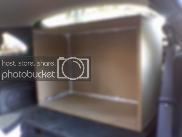

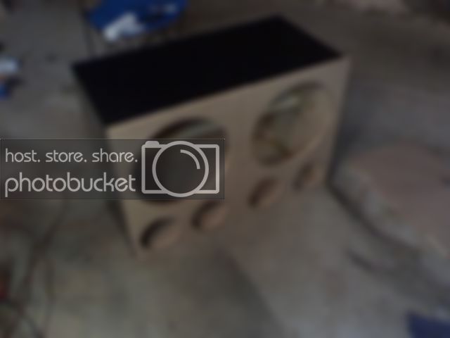

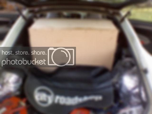

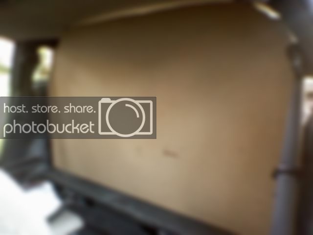

I will be cutting the holes for the subs and aero ports tomorrow. Will be painting the BOX tonight with bedliner, and will put the rest of it together tomorrow, and paint the rest as well.
Hopefully i will also have the battery rack and the mounting board for the amps done before i get the subs. Will try to get them done tomorrow.

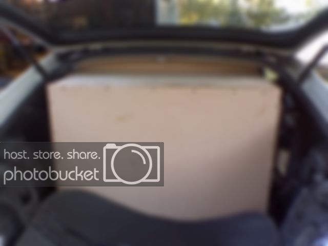

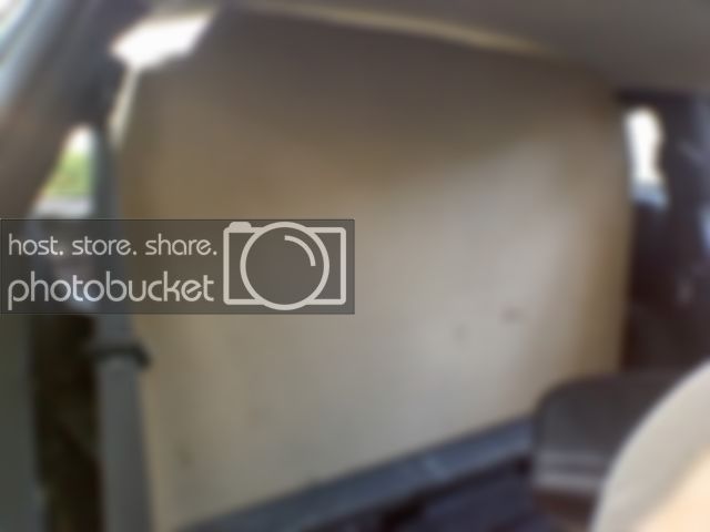

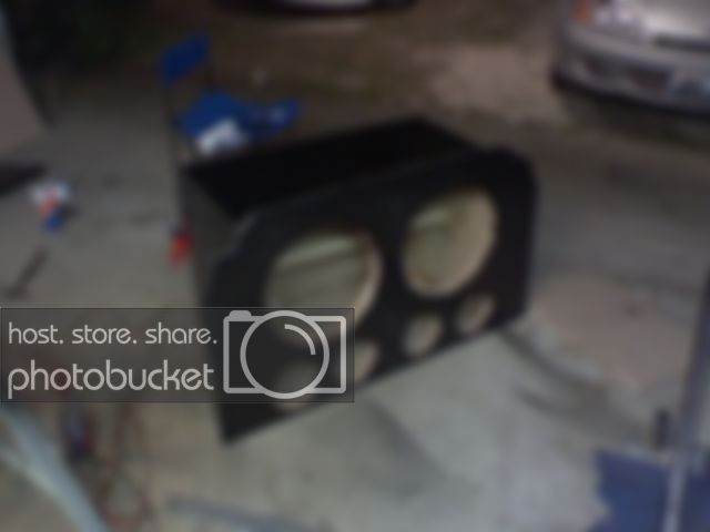

the box does seem tiny for two 15s but i made it relative to Soundstreams specs. they prefered 2 cu ft MINIMAL ported, with one 4 inch aero port...and 3 cu ft OPTIMAL, with 2 4 inch aero ports each woofer. the box before displacements is 6.60 cuft. after sub displacments that leave 6.4 cu ft. and after port displacements thatll leave between 5.5-6.0 cu ft left in the box. I do hope everything sounds ok when it is all said and done though.

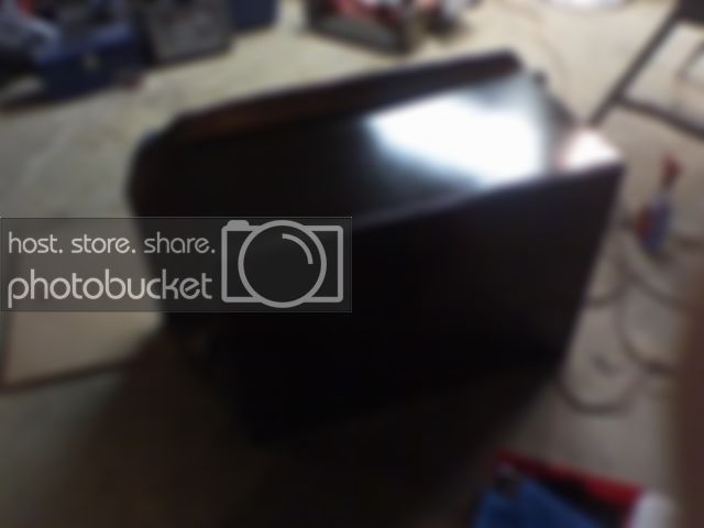

Two SoundStream SPLX 15s. I just applied the 3rd Layer of the High Gloss black paint tonight and it will be dry in the morning. They will be tuned to 43 hz, with 4 4-inch aero ports, each 10.25 inches long Flare to Flare. I will hopefully have the subs by next week.
