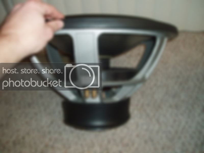

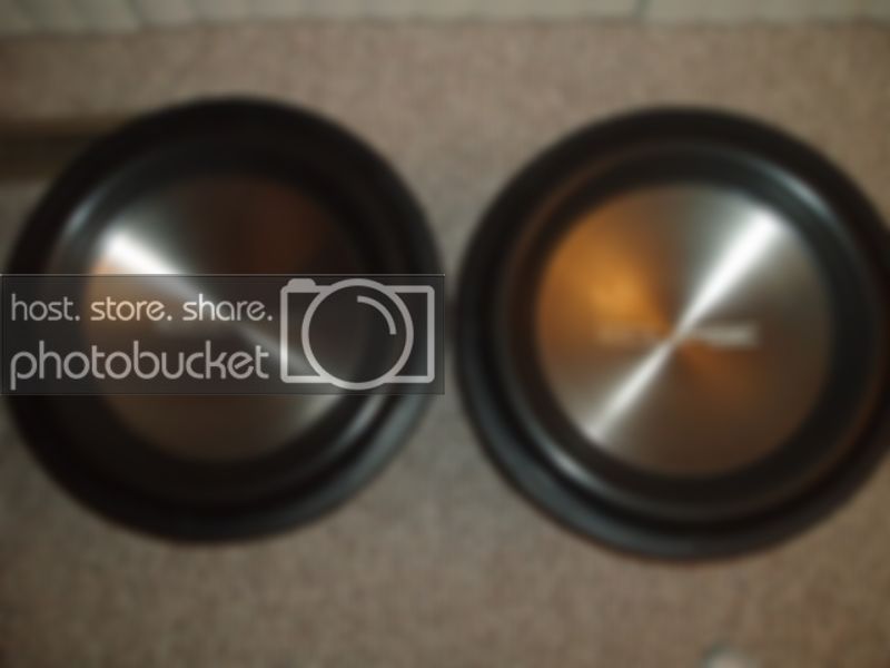

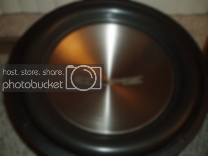

Eclipse never made a Ti 18. Unless you got the origional Ti with the 3hp motor reconed to an 18 that is.
They made a Ti pro 18, though. 4 hp motor.....4 inch coil.....Those things will SOAK up power. Sick subs if you have the power for them. I wouldn't hesitate to throw 5kw at one.

Many Ti pro 18's were made, no Ti 18 (non- pro's ) were officially produced for resale. The ones in the picture above never touched Eclipse's hands. They don't even have mesh screens on the basket, official Ti's all do. (implies after market recone as stated)
