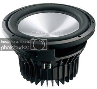

The first driver pictured is the SW8200 and is indeed a TC design. It is an LMS driver.

Yeah, sorry. I wasn't trying to correct or anything, I just noticed that the driver that was actually pictured was the SW8200. They're the same other than one being a 10" (SW8000) and the other a 12"(SW8200). I hope it works out for you. //content.invisioncic.com/y282845/emoticons/smile.gif.1ebc41e1811405b213edfc4622c41e27.gif
