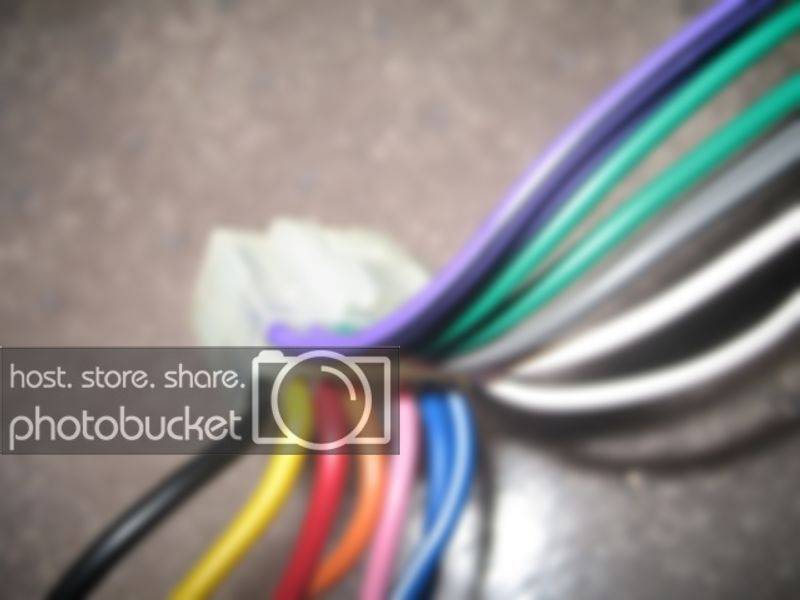

Does anyone have a pic of their eclipse harness or a diagram so I can see what order the wires are in, I lost my orginal harness but i have a spare 16 pin harness from a broken deck and it fits in the eclipse. I just want to relabel the wires in the spare harness so I dont acidentaly wire the wrong wires.
You're in luck. Here's an eclipse harness from a 3434:
Top row:
Purple/black, purple, green, green/black,grey/black, grey, white, white/black
Bottom row:
black, yellow, red, orange, (empty), pink, blue, blue/white
