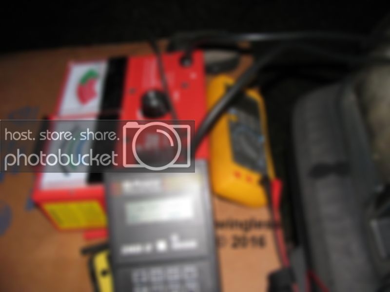

If I were to check the calibration then I would put a voltage multimeter right across the load then use Ohm's law, I=V/R to calculate the actual current based on the measured voltage and the measured load resistance.

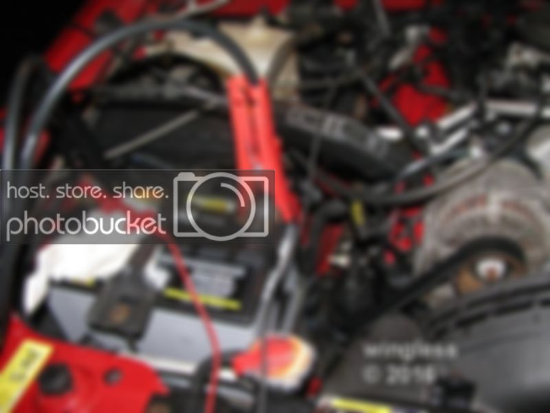

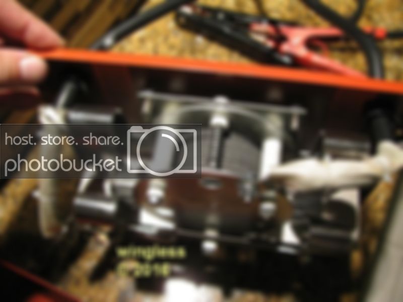

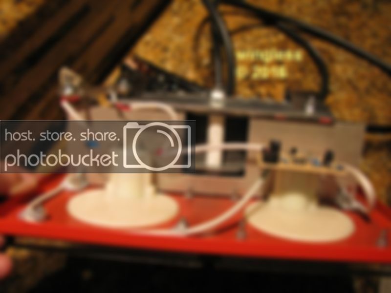

The tool I would use for the load is an adjustable carbon pile load. Here are some images of mine when I was testing the generator in my Jeep. Note that I have a really nice clamp on meter that would be perfect if I wanted to make this measurement.
