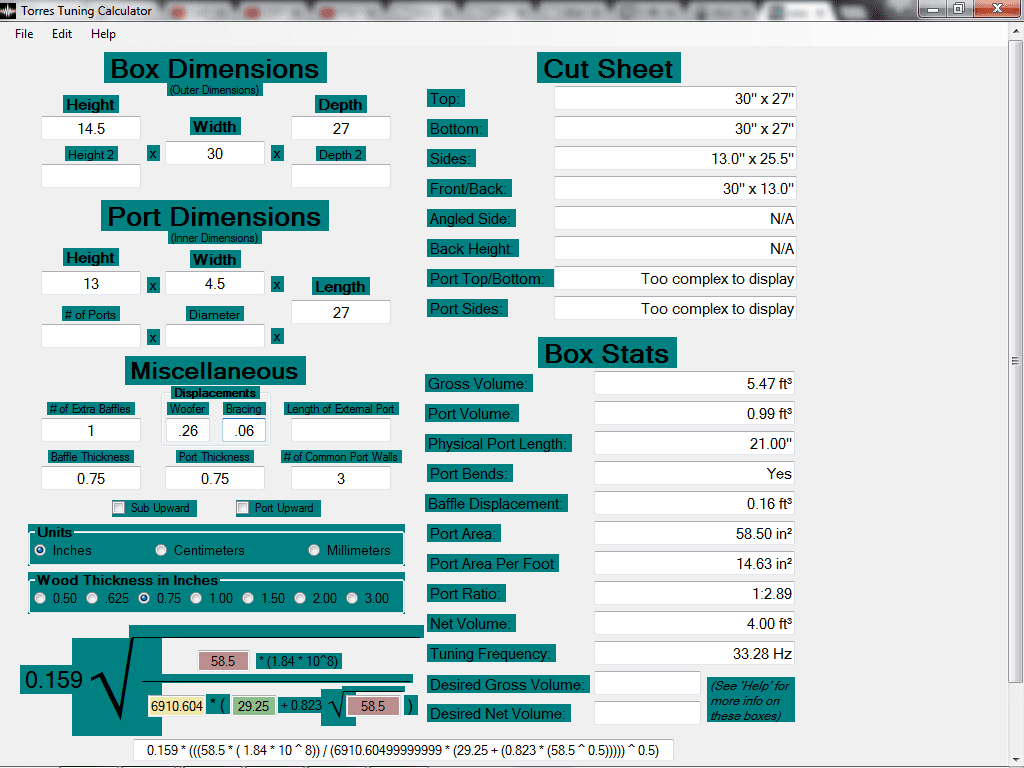

Hello- I am trying to figure out how to design a box down to a cue; but I have a lot going on plus working 70 hours a week right now..
I'm really aiming to have a cut sheet by this Friday. So.. need to get this ball rolling.
if anyone is willing to help shoot me a private message
I'd like the enclosure to be up to the following:
14.75Height
30.75Width
OPENdepth up to 3x.xx or so..
tuning of 33hz.
4.0Cubes NET VOLUME
According to some other thread topics 0.13 seems to be displacement - so... 0.26..
as this will be my first enclosure- I'll let you decide upon bracing - double baffle flush mounts.
two American Bass XFL 1244s
please and thank you to anyone who wishes to pursue!

okay, I am slowly making ground..
[surely the wrong direction]
the port height being 13.. it's on inside so.. that's just bottom to top.. right?
is the width... the opening...?
the length being.. 27..
http://i62.tinypic.com/3358vfm.png
I guess I am still a bit confused about the numbers given..
can anyone color me a picture preferably in Crayola
not exactly 33hz, somewhere between 33-34 but its just to give you an idea.
Wow- thank you buddy! I appreciate it!
If I were to add double baffle for flush mount (aiming for a clean looking install.. Good with the production end not designing) effect my tuning? As it will add .75inch to the port length.

oh yeah didnt include the extra baffle but its already calculated in there with the tuning and cubic airspace if you put the 2nd baffle inside the box( two of 13" x 11.25"). However if you make an exterior baffle(two of 14.5 x 12.75), it'll give you some airspace back and put you right at 33hz around 4.10 cubic feet net instead.

Ok I'll include it in the interior.
Will double baffle provide enough stability to remove of majority of flex? Are any dowels needed? Using vfl4480.. does 2250 at @1.. So a smaller system.

I wouldnt expect too much out of that vfl but you wont need that much bracing, the double baffle along with center port should act as very good bracing already.
