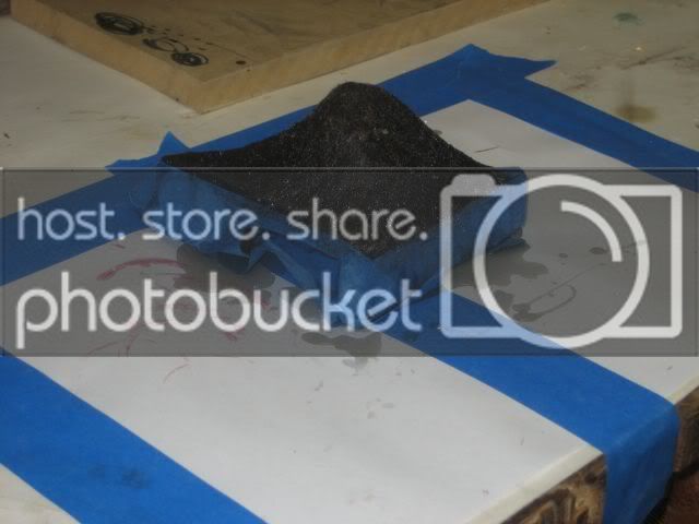

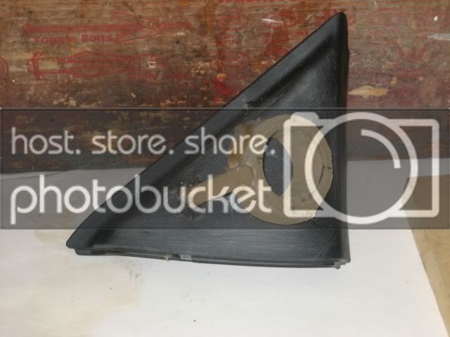

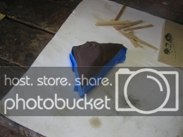

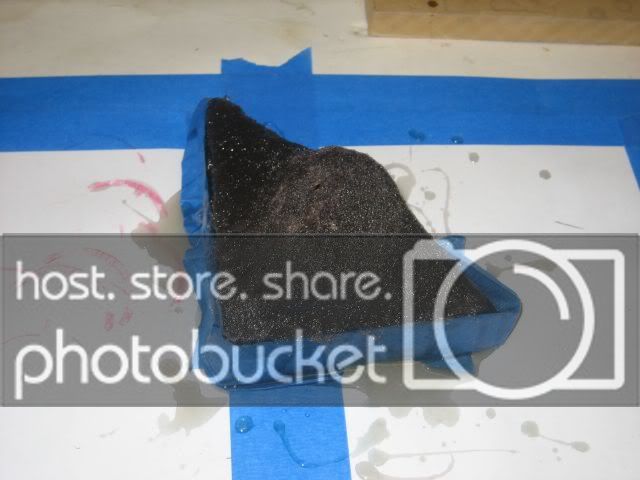

Here's some pics of my tweeter fab. I'm doing now into the sails.
