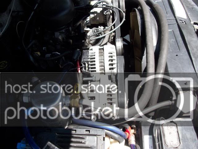

Awesome! Thanks for the link. That's almost exactly what I was thinking of doing. There's a lot of room up top, so if I modify the stock alternator mount a tad, then there'd be plenty of room for a second.
(Just took that pic)

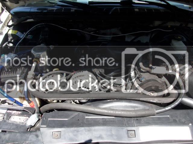

i have a 1996 4 door, 4WD, 4.3L Blazer. I am desperately trying to figure out a dual alternator setup using two stock (preferably ad244) alternators. I am willing to give up A/C if necessary. Could you give details/pictures of your setup? It would be greatly appreciated.
sparkplug (and anyone else) - i have a 1996 4 door, 4WD, 4.3L Blazer. I am desperately trying to figure out a dual alternator setup using two stock (preferably ad244) alternators. I am willing to give up A/C if necessary. Could you give details/pictures of your setup? It would be greatly appreciated.
Its not hard at all. you will need some steal and a grinder and a drill with some bits. I put mine next to each other and just used two ad244 alts and piggy backed the plug to have two. Pic...
