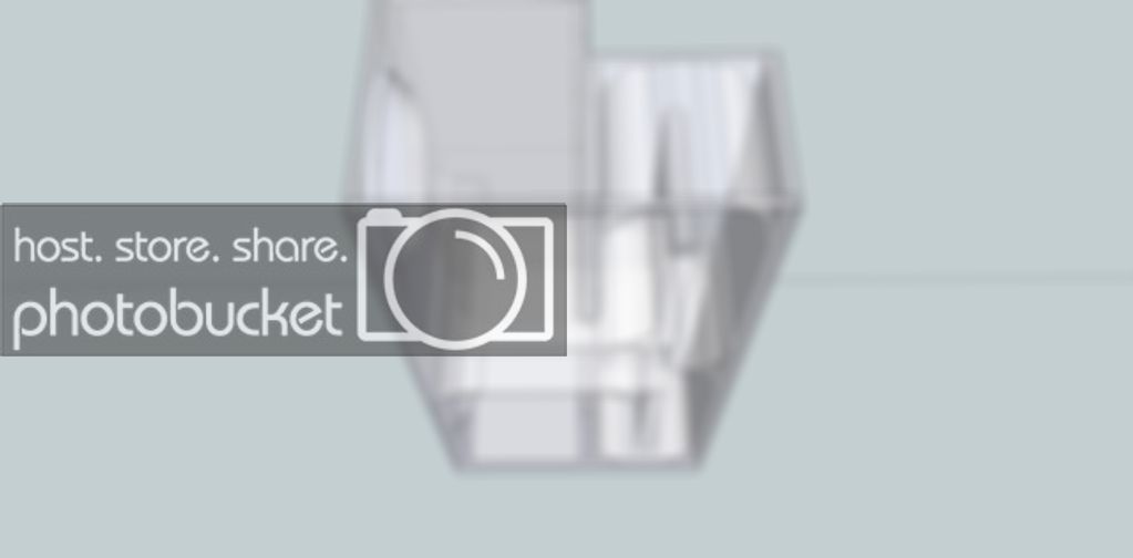

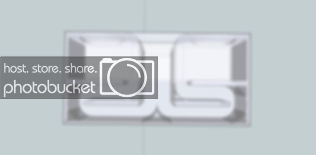

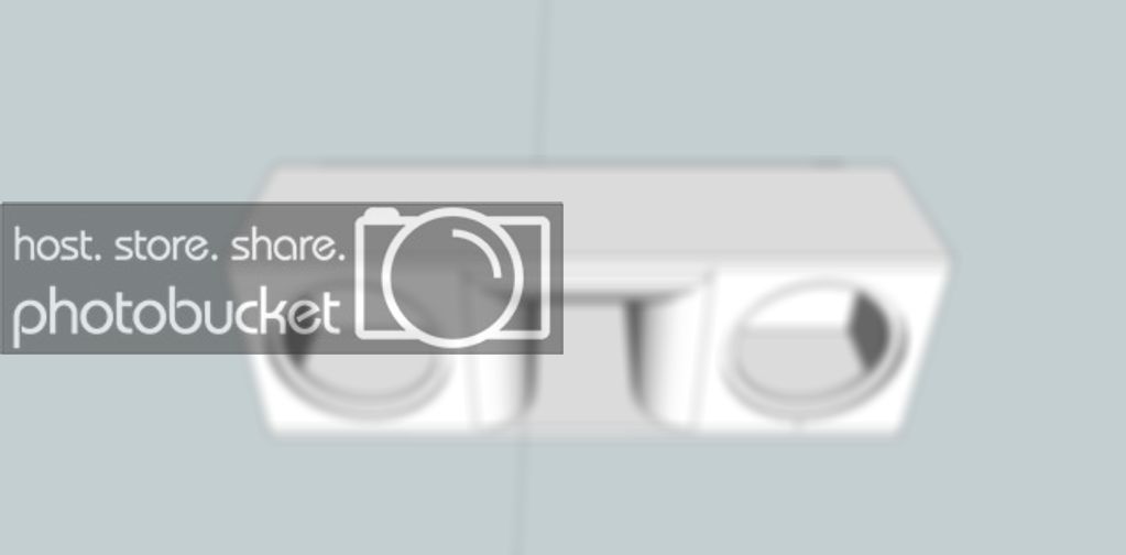

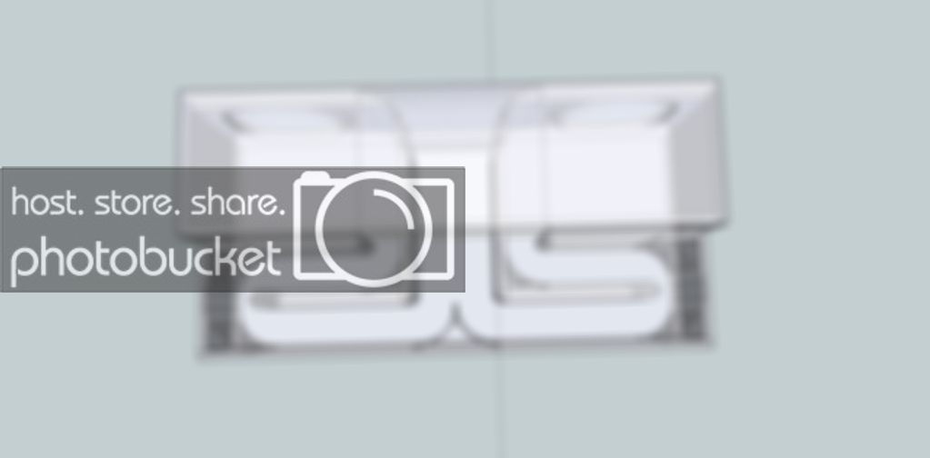

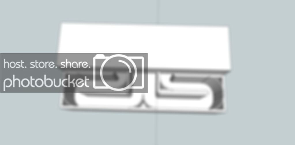

If you look at the drawing it actually shows the inside of the ports done with PVC.
well after doing box after box i tend to get good guesses lulz. i cant wait to see how it turns out. and instead of kerfing wood for those corners. get some pvc pipe or sonotube and cut them in half. its a cheat i like to use //content.invisioncic.com/y282845/emoticons/wink.gif.608e3ea05f1a9f98611af0861652f8fb.gif
You sir, are a genius!
Whoa, that will be one skinny port. The width of the back wall ports will be 1.08" wide (27.5mm), but the front port will be shared by 2 subs so...
