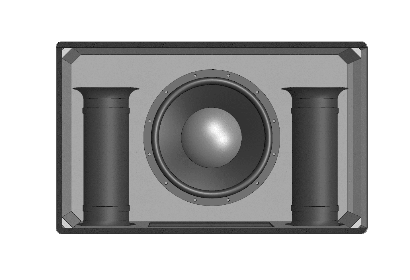

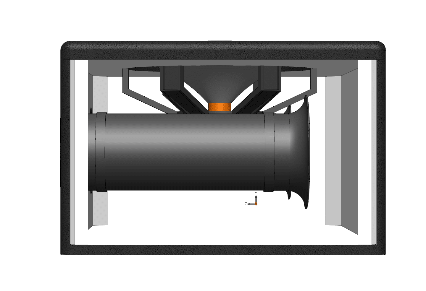

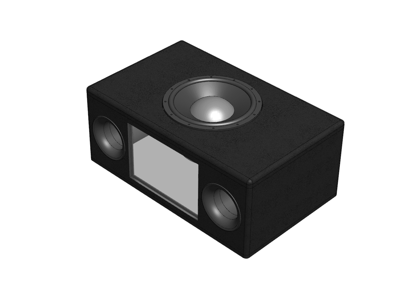

Just finished these, I think this will be the final version, I might try drawing an "AQ" on the plexi, but that's about it.
I've had good luck with down firing. You may consider using pilars to keep it off the floor since if you do full side walls it'll act like a bandpass and you will have unpredictable results.
Looks pretty, what are the specs and the woofer and the power going to the woofer?
I'm sticking an AQ HDC3 18" in there on 1500 watts.
41.25 x 16 x 25.5 ~ 8 cubes
two 6" aero's so 2(28.25) x 19.5 ~.65 cubes
~.2 cubes of sub displacement
~.05 cubes for bracing
sub will see ~7 cubes
ports are tuned to 32hz
