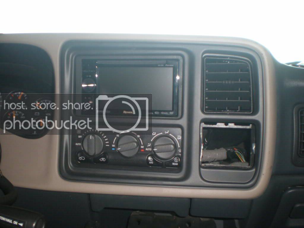

forgot i had pics, and forgot a step:
Remove the headunit and climate control unit.
Cut out the dash support to make room for the depth of the headunit:
This is how an 03+ double din bezel lines up stock
Move the climate controls down by breaking off the guide pins, and using bolts to bolt through where the guide pins used to go
In order to be able to move the climate control unit down, you will first need to break out the bottom of the dash cage:
Then figure out a way to securely mount your unit in. I made an MDF cage that fit nicely, and tah dah:
