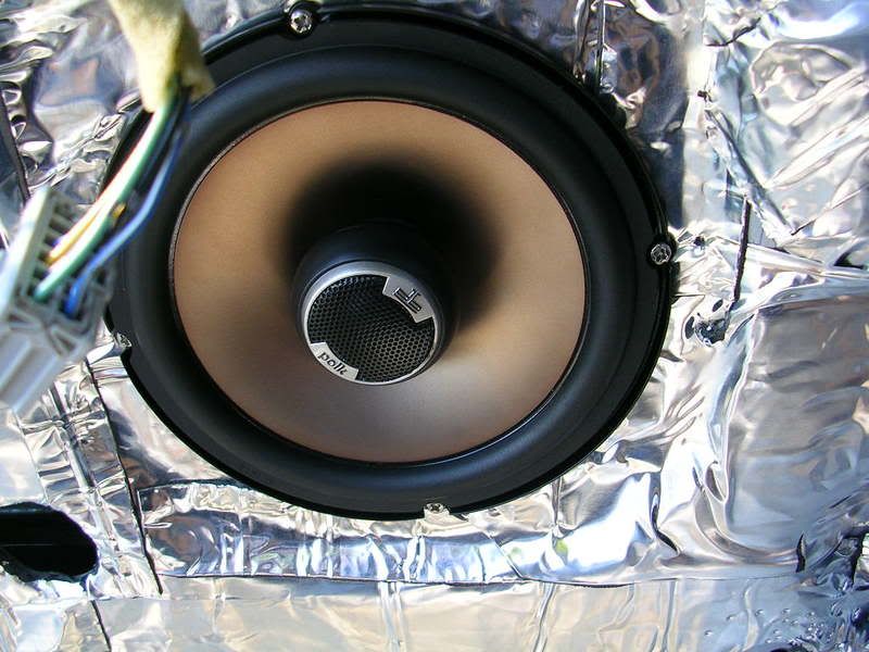

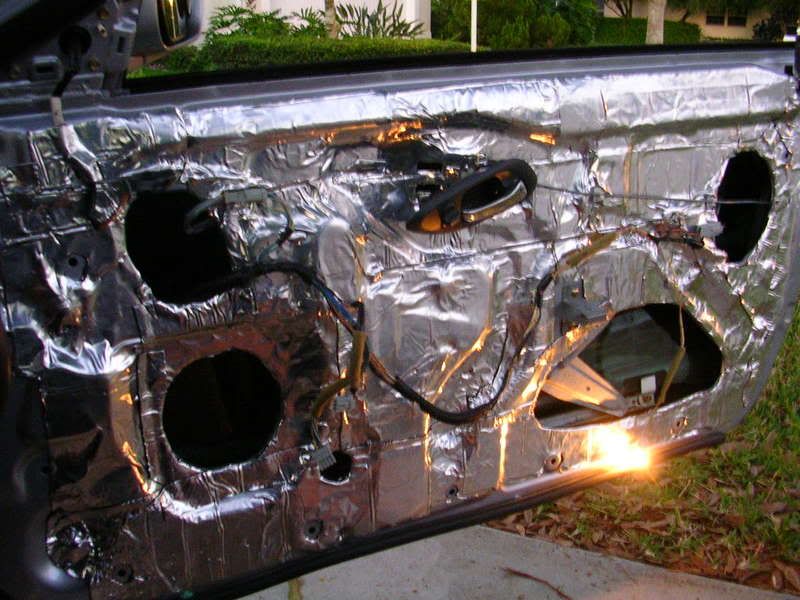

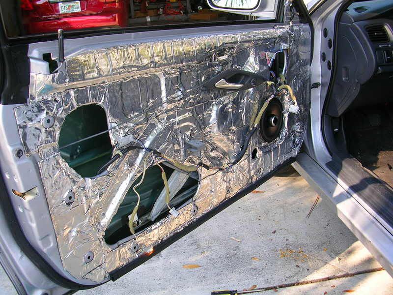

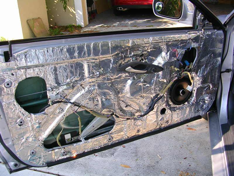

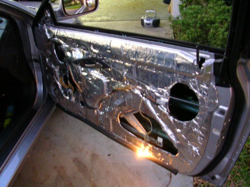

Last week I ordered 20 sq ft of Damplifier, and just got it the other day and had to time to put it on today.
Great stuff, will definately buy more when it comes time to do the entire car. //content.invisioncic.com/y282845/emoticons/biggrin.gif.d71a5d36fcbab170f2364c9f2e3946cb.gif
The Polks are just temporary until I get the Rainbow's ordered. //content.invisioncic.com/y282845/emoticons/eek.gif.771b7a90cf45cabdc554ff1121c21c4a.gif
You need to do the outer skin of the door, at least two layers...and I realize those Polk's are temporary, but when the real speakers come you should mount them on a baffle of 3/4" MDF and modeling clay.
Seal up what holes?
The big gaping ones on the inner panel //content.invisioncic.com/y282845/emoticons/smile.gif.1ebc41e1811405b213edfc4622c41e27.gif
Ohhhh ok I will order more and do the insides of the doors, correct?
And how do I go about sealing up the big holes? 1/4" mdf?
