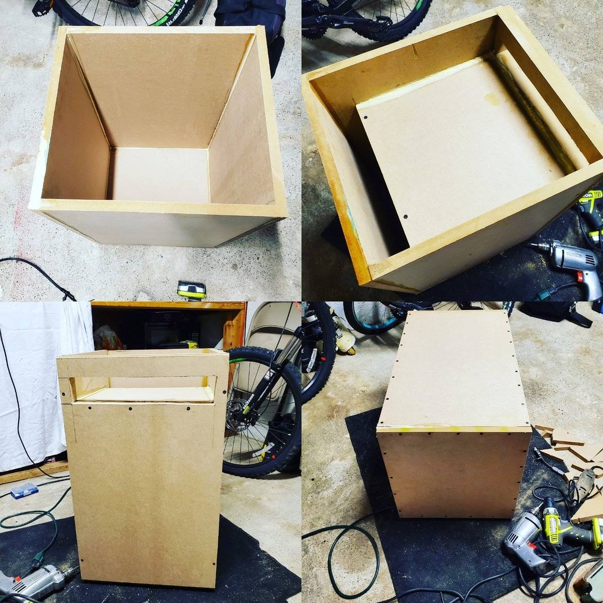

Made a custom box with JL Specs.
Thanks in advance for any help or suggestions.
Attached some pics to show what the build looks like.

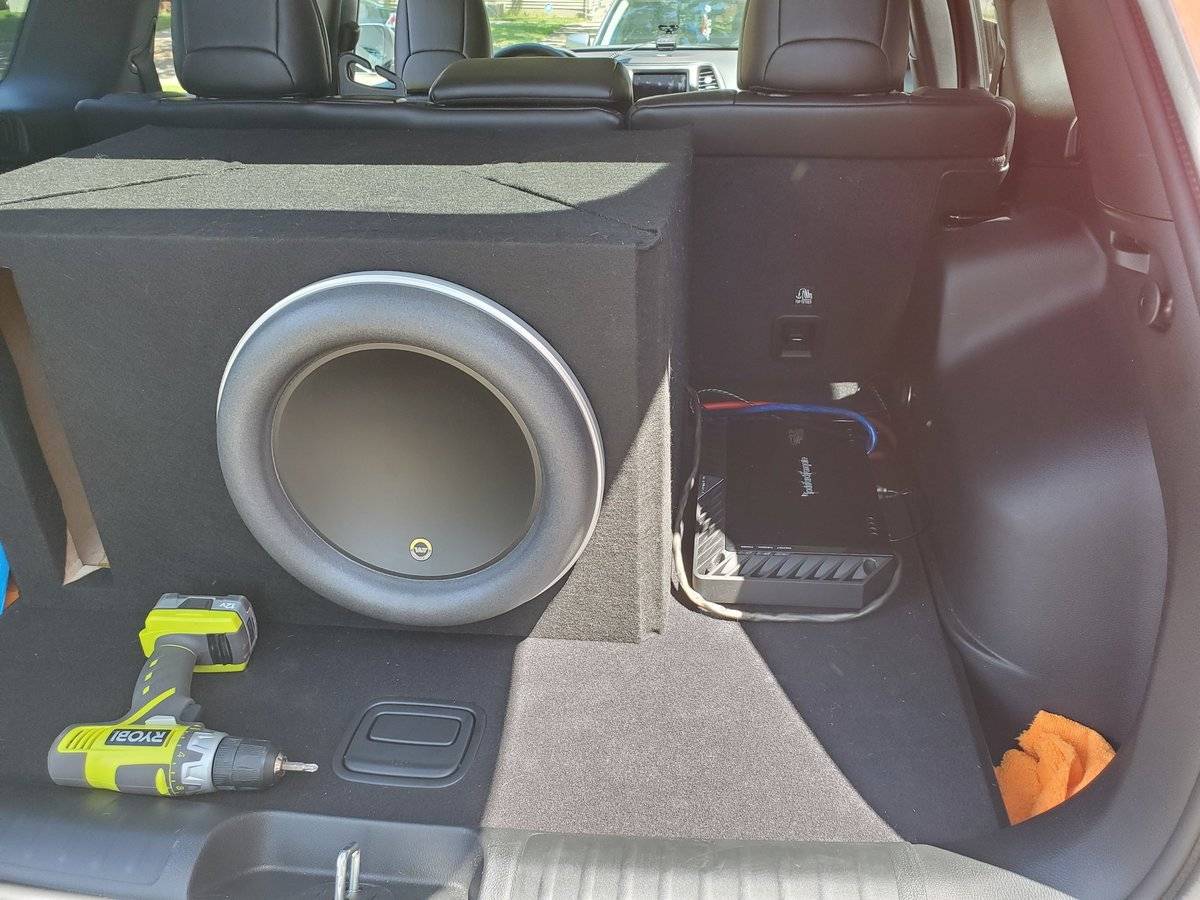

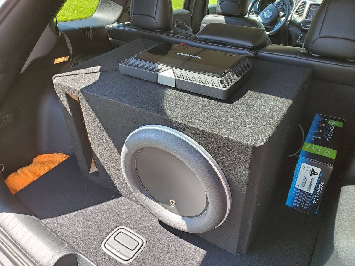

Amp mounting tips: don't mount the amp on the box because 1. vibration takes its toll on the amp, 2. it makes it easier to steal the entire package, 2. the amp is visible increasing possible theft, and 4. if the box moves the amp wires are less flexible and can pull out.  I assume you've securely bolted the box to the floor.
Thank you for the response. The box is bolted down with 2 L Brackets in the back. Keeps it perfectly centered and wont budge. I'll def have to move the amp somewhere else then. I did not think of how the vibration would effect it. Thanks for the tip.  I know about the EQ Boost. I bought it because someone told me it was a good idea and I haven't even messed with it at all so it was pretty much a waste unless I adjust the EQ Knob to max and set my gain but I dont know if thats a good idea or not. When I was setting the hz I tested that theory at EQ knob all the way down was about 22v leaving the sub under powered at that point. I've never used an EQ Boost so i'm better off not using it until I know how.

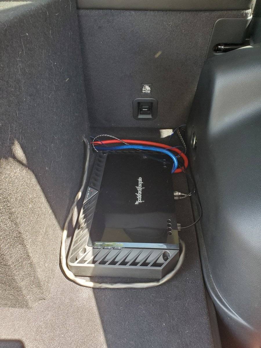

Ok So I attempted to mount the amp to the back of the seat. The angle of the seat forces the bottom of the amp to sit onto the carpet as well as closing in the area which would allow no air flow so I decided not to mount it there. I ended up just remounting the Box over to the side and mounting the amp to the floor instead. It doesn't look the best but it wont be on the Box and maybe the air flow from the Subwoofer Port will help keep the amp cool. The ground wire just barely reached with maybe 2 inches of slack.
